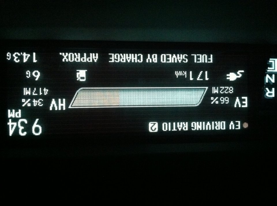

    Just shy of triple digits. It looks like it will take 2/3 EV and 1/3 HV for me to reach 100 MPGe.
    I had to drive out of state. Flying to Cancun so I will probably reset and start over when I am back.

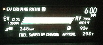

    2nd tank
    Still #2 but a better #2
    Formula still not working for me - I was 40 miles shy of 1,000 and at 155 MPGe
    when the dreaded ICE kicked in... that changed me from .5 gallons to 1.5 gallons thus MPGe plummeted 20 to 135
    in one mile !
    Yesterday I had an unexpected longer trip, drove 30 gas miles and my MPGe climbed to over 140 since those gas miles added to my total miles but not against me as I remained at 1.5 for the formula
    EV miles divided by fuel saved by charge would be a less wrong assumption in my opinion and require just one pic
    or a flat assumption of EV miles / 53
    Either one would eliminate being off by a half gallon unless I'm missing something

    I'm not sure what you're asking so I'll lay out all the numbers I have :
    Week ago : 960 total miles on this tank. 907 EV 53 gas. 161kwh so 5.62 + .5 (was reading 0) = 6.12
    960 / 6.12 = 156 MPGe
    ICE kicked in next mile bumping read up to 1 gallon = 1.5 for formula purposes
    961 / 7.12 = 135 MPGe for a drop of 21 in one mile
    I've since added 36 gas gallons (as you can see from pic I'm at 90 now) and just 50 EV due to that trip.
    957 EV 90 gas 169 kwh so 5.9 + 1.5 = 7.4 1047 / 7.4 = 141.5 MPGe
    My suggested way would've had me pretty close to a full gallon before ICE kicked in and pretty darn close after too
    instead of .5 in the mile before and 1.5 right after...
