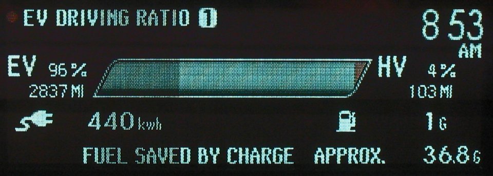

    WOW this is one amazing result!
    about 158 charges in August! this is almost 6 charges a day on average! Any time to do something else?

    That was from April 5th to August 29. :)

    I total agree, this is my HV mpg since new. HV miles 5202, 38 percent 50.89 HV mpg.
    I had 5 gas fills bring my car back from the west coast, winter temps time frame, cold windy, 65-75 mph, 26 degree temps and driving into 35 mph winds on left front of car, drove non stop so no charging at all. Only got 44.26 mpg for 1505 miles.
    Since then I have 3696 HV miles and averaged 54.19 mpg.
    So I guess If you were to average at 53.0 miles HV you would be really close!
