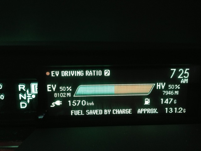

    Don't think I am doing the math properly. Would someone help me on this? Attached is my lifetime EV/HV ratio screen
    iPad ? HD
    iplug likes this.

    That is about 83 MPGe. The 1570 kh is equivalent to 46.58 Gallons using 33.7 kWh/gallon (EPA) (0r 46.04 using 34.1kWh/gallon which is a pure gas formula)
    Since the car truncates gas you are between
    16048 / 193.58 = 82.9 MPGe
    and
    16048/194.58 = 82.47 MPGe

    You didn't figure in the 15% wall to car differential that we are using.

    My bad..
    Then its 80MPGe.. 1507*1.15 = 1805/33.7 = 53.5 Gas equiv. so 16408 / 200.5 = 80MPGe.

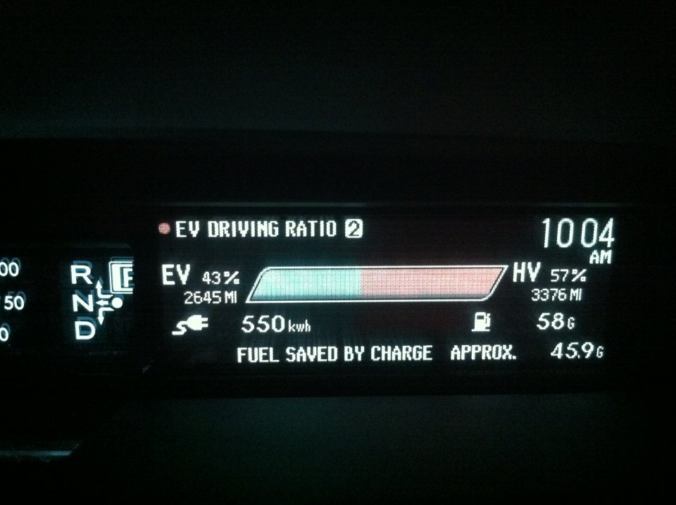

    Still not sure I understand MPGe correctly...but here is my ratio screen for lifetime of car to date.
    Thanks Markabele!
    usbseawolf2000 likes this.
