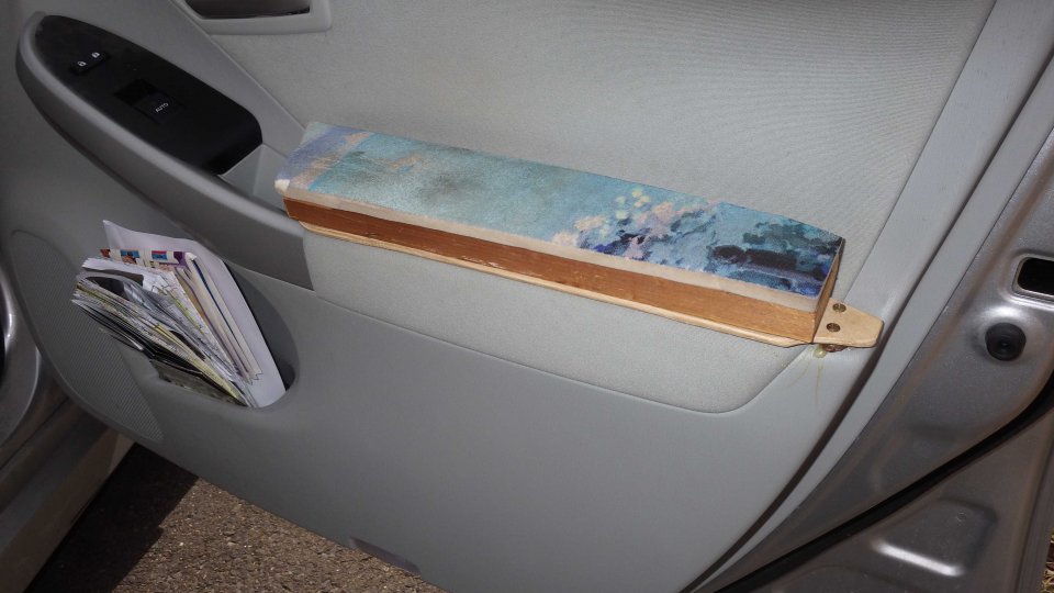

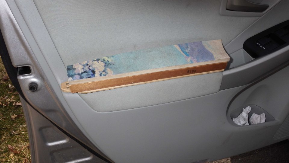

    Hey there @Robert Holt. How about a pic of the raised armrests?

    But sure I can post pics of the arm rests! Here are pics of the passenger side and driver side arm rest. I shaped a thin piece of 3/16" plywood to fit the oddly-curved shape of the armrest (kind of kidney shaped). I tried using industrial Velcro to affix it and that failed after a couple hot months. Then I screwed that base plate to the rear of the armrest with very small brass wood screws (seen in the pics below) and, using a small brass hinge, to the inside of the pocket at the front of the armrest. The attachment point is at the rear of the pocket, so it is still basically empty and the door can be opened and closed in the normal manner. tell me if you want close-ups of the mounting or anything. Atop the base plate I installed a 1 inch layer of wood for stiffness and then then a 3/4 " layer of closed-cell foam cut from an old kitchen mat for cushioning. The result is:
    Let me know if you want more pics or construction details.

    Thanks for pics Robert Holt. I get the idea now.
