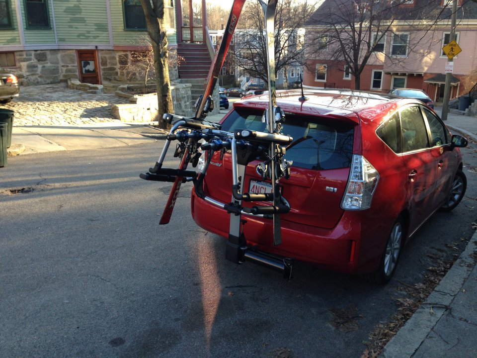

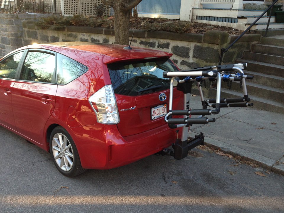

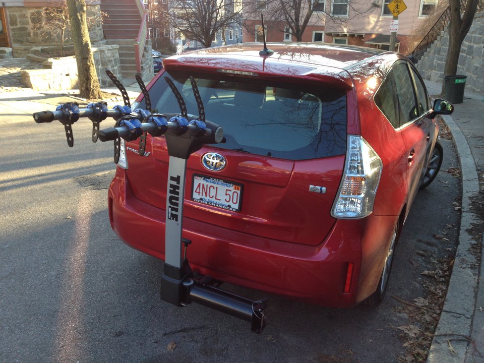

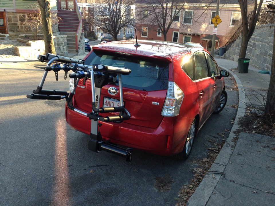

    I just installed the Torklift EcoHitch on my Prius v and took it on its first ski trip with the Thule Apex Swing 4 (bike rack) and Tram (ski rack attachment). I could never find pictures of this combination or anything close when I was researching what to buy, so I thought I'd share.
    I got 39.6 mpg on the ~360 mile trip with the racks and two pairs of skis and a car full of family.

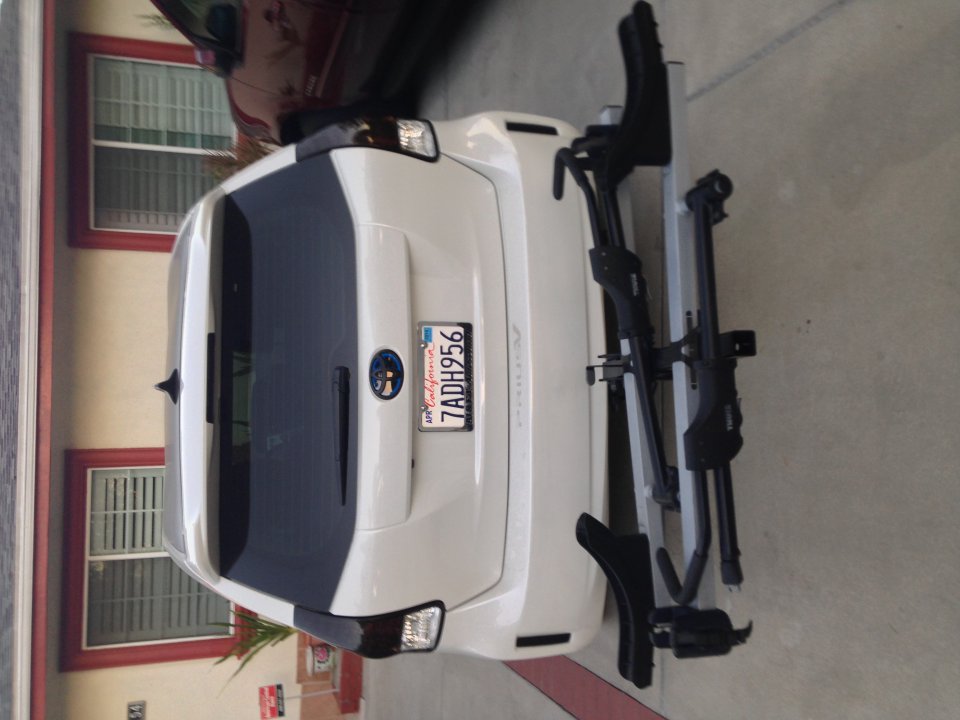

    Haven't been on in a while, but thought I would share. I too, installed the EcoHitch 2" and used my Thule Rack... only 2 bikes though. See pictures. photo-5.JPG photo-4.JPG photo-6.JPG

    Now what's the advantage of the system that you have where the bikes are attached at the bottom vs. the other style where the bike hangs from the frame? Or is it just a matter of preference?

    The bottom type provides simple & secure bike carrying. The catch is you are limited to 2 bikes.
    The other offers the ability to carry up to 4... which is what I have (with a 1.25" hitch) and it's worked quite well.

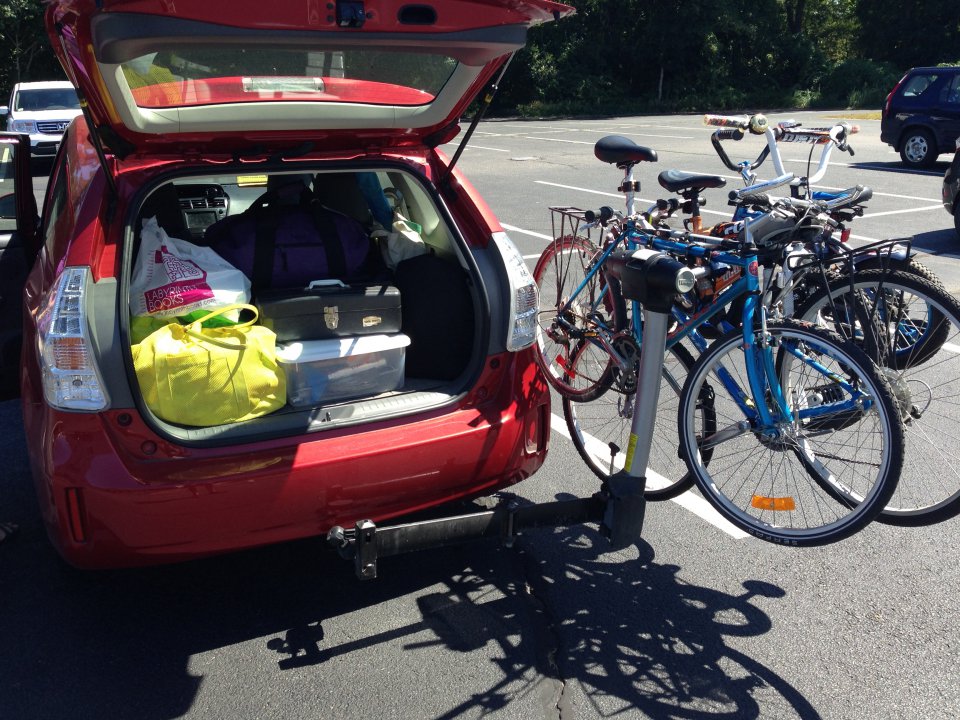

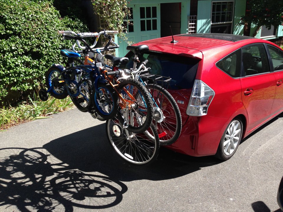

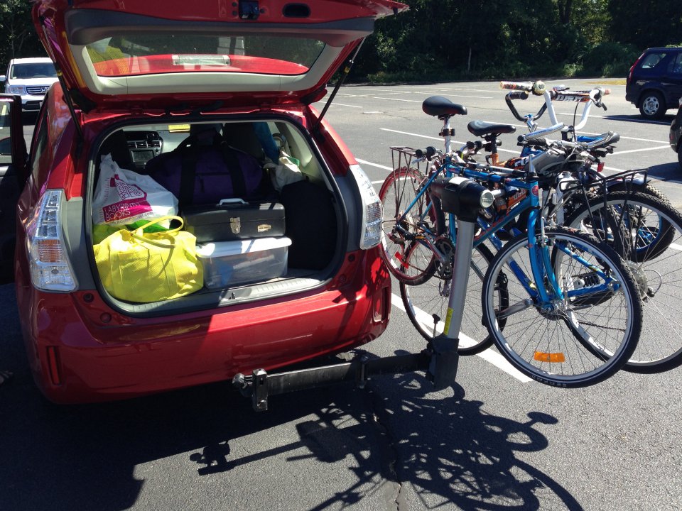

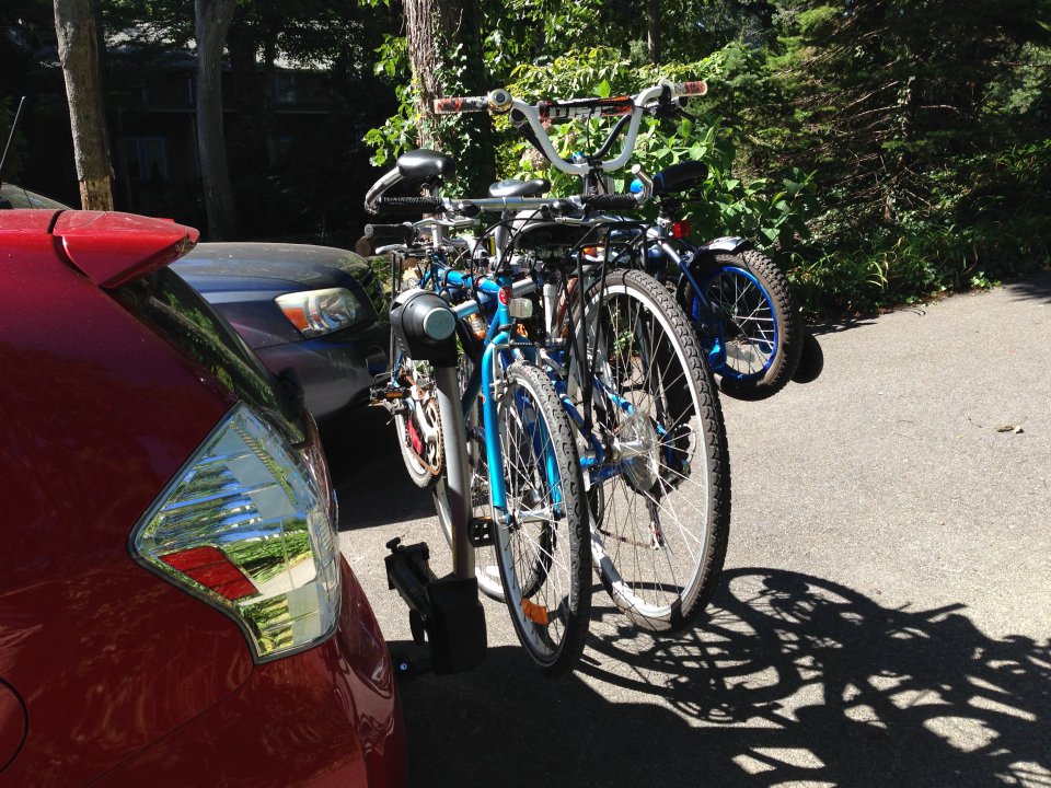

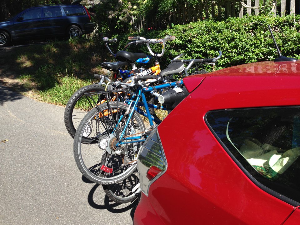

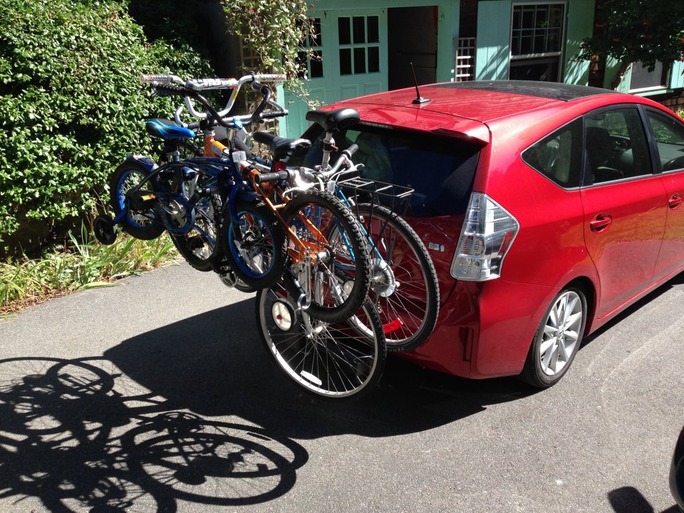

    Update from summer 2014 -- fully loaded with 4 bikes.

    Thule Apex Swing 4 (see original post above for more pics and description)
