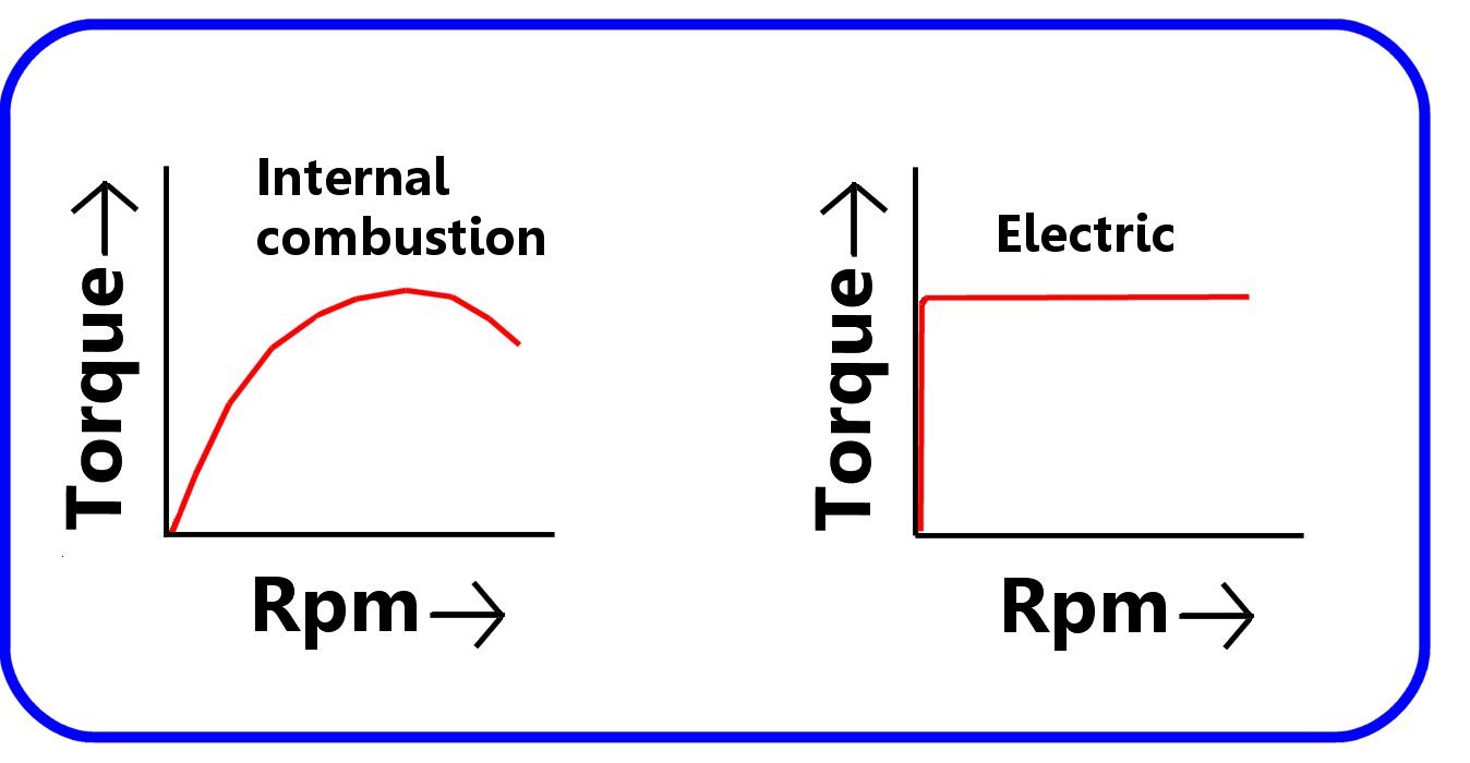

    Very few people graph the torque curve of the Prime. If you google, you may find one, I couldn't with a cursory search.
    In general this is what the EV vs ICE torque curves look like.
    If your friend has an ICE, he has 0 Torque at idle.
    You may have better luck comparing 0-20, 0-30 or 0-60 times.
    Unless he has a very exotic ICE, most EVs would just embarrass him off the line.
    In a longer race, he may win, depending upon what he is up against and what he is driving.
