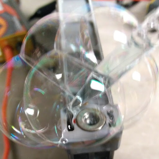

    Sometimes just unbolting the modules from the case is enough to break the leak path.
    A controlled charge and soapy water will find leaks. Using a 12 volt power supply would require a resistor to limit the current flow.

    What might be a good charging voltage to use for charging individual modules so that I can leak test with soapy water from spray bottle?
    I have a Honda motorcycle resistor that drops 12 volts down to around 7.2 volts for the Honda temp gauge that I can use. Will 7.2 volts be enough to generate enough heat to check for leaks?

    Did you find the leaking module?

    In that case spraying soapy water seems like a wise thing to do when doing diagnostics, right?

    I have used balloons also. Yes, the stuff that gets vented is nasty. Release of oxygen gas is part of the charging process but when the vent opens it takes some of electrolyte with it. The vents open at a wide range, 80 to 120 psi so I think the venting is kinda random.
    Leaks are actually pretty rare in the great frozen north. More common in the south but still rare. Soapy water is just another tool to identify the source.

    I could not get any of the cells to make bubbles but if i test each cell separately with a voltmeter - using the mounting threads at the bottom of the cells as the ground I find 5 cells that showed low voltage readings between .01 and .3 volts. (None of them show anything near 8 volts doing this test yet they are all charged to a little over 8 volts and holding there)
    This testing is with the cells out of the case testing both positive and negative against the female threads under the cells.
    I was heading over to Tampa Hybrids as they have used cells at a good price. While stuck in Traffic during rush hour - I decided I'd Try going "Cuban" on the battery before adding used cells. (The Cubans kept their old US cars running with inventive repairs as they couldn't get parts from the US for decades)
    I have plenty of money to do this job with new parts so this is just for fun.
    I have sealed the bottom of the cells with GE silicone and insulated the bottom of the cells from the mounting blocks. I did not put the screws back in the bottom of the offending cells as I have cut plastic and inserted under the offending cells thus blocking the mounting holes on those cells. The 4 clamping bars hold the cells in just fine as they all interlock and all the good cells have their mounting screws. (I can pick up the entire battery by the cells and they don't budge)
    Currently, I'm polishing all the brass before bolting all the cell terminals back together.
    I don't know how good this will work but so far - meter readings are good!
