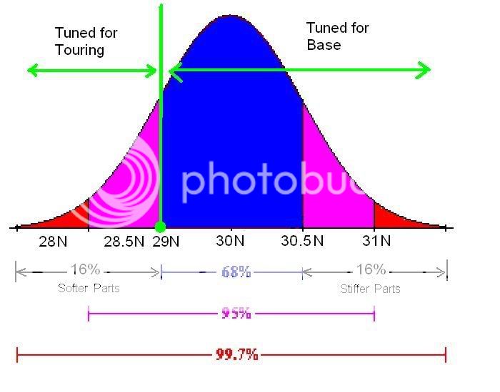

    What is "Tuned" suspension? I have a suspicion it is 10 percent tires and 90 percent marketing hype.
    Remember the old "Bell Curve" they used to grade you on in school?
    This curve is a standard distribution that represents variations in almost any variable.
    So I'm thinking all of the stabilizer bars, torsion beam, springs and shock absorbers are coming off the same assembly line. Then they are graded like this and lop off whichever end of the curve they need for Touring (the softer side in the case of the rear springs) and mark them with the Touring part number.
