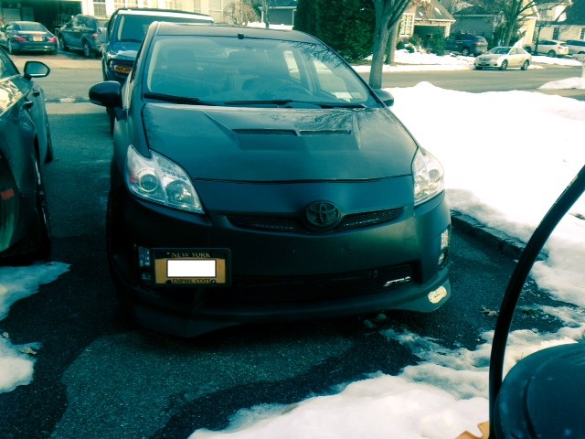

    I bought a colored tow hook from e-bay for $10-15. Took off the colored end and was left with a straight threaded end. From there a trip to Home Depot. It is easier to attatch to the threaded end than the toyota hook which has a loop
