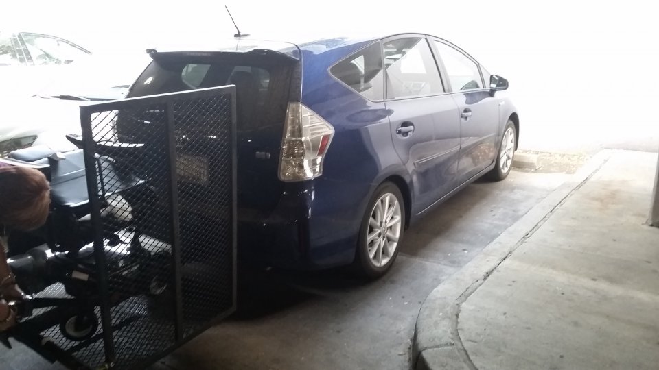

    I ordered my torklift hitch to haul my wheelchair I'll post pics once I get it installed
    image.jpg Here it is with my wheel chair and it's a 2" hitch from torklift get stuff fit great too

    Looks great how much does it weigh?
  11. Sportwing
    Sportwing New Member
    Sep 12, 2014
    Marthaville la.
    Hitch is lite but my chair and basket weight aprox 210 lbs
