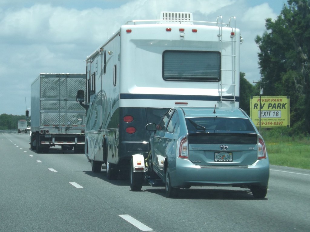

  3. pmike
    pmike Member

  5. Easy Rider 2
    Easy Rider 2 Senior Member
    Aug 5, 2014
    1,584
    258
    Ocala, FL
    2013 Prius c
    Look for a different tow company.
    IF.....they don't lift it too high and don't go too fast, there is NO reason that a standard tow rig won't work just fine.
    Same for the dolly behind an RV. IF......you get a dolly that doesn't raise the front end too much you should be fine.
    The picture posted looks fine to me.
