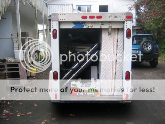

    Yes you can pull a trailer. The engine revs more but it seems ok. Heres a few thousand words worth of details:
    If anyone is wondering it gets about 25MPG pulling that empty or full, its like a big parachute.
