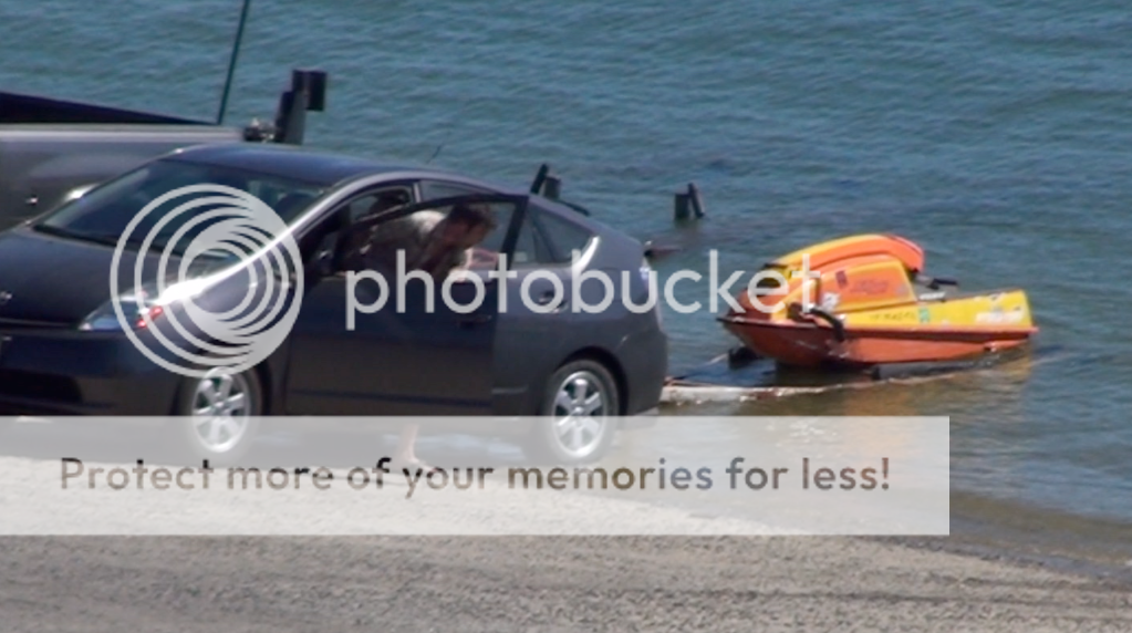

    I average 41MPG with the Jetski, usually it's around 47/48MPG in my car...

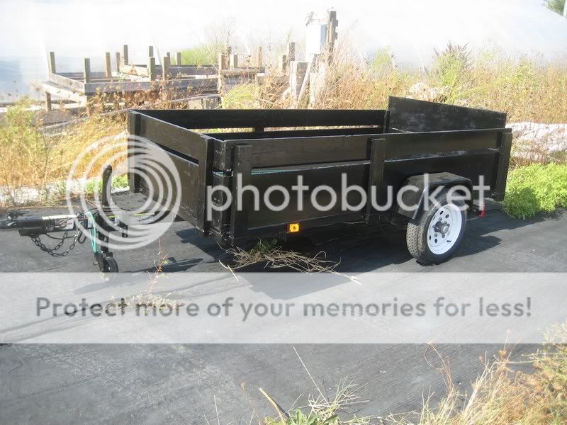

    I
    It's not much to look at, but it was free. My father-in-law had an extra trailer and that saved me from restoring one I had on the farm. I may still do that as a winter project, but for now this will work. It's a sound trailer and transported empty about a 70 mile trip averaging 35mpg. I'm sure it's mainly the drag keeping me down. I kept to the highways because around Louisville there are some real good bumps that will make an empty trailer come off the ground at 65. In a truck I wouldn't mind that too much, but a lighter weight car that I paid for makes me more cautious. :)
