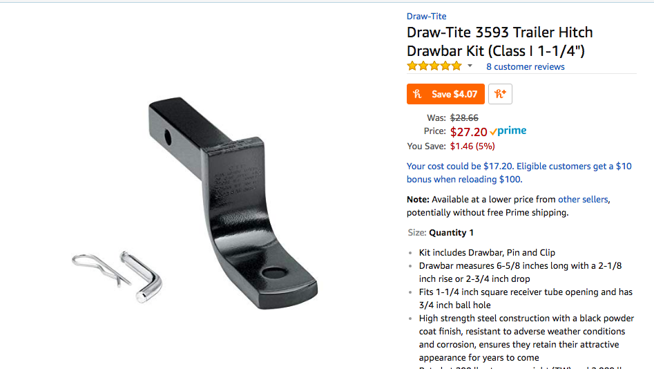

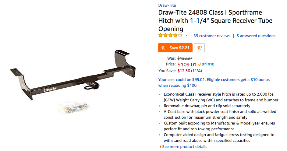

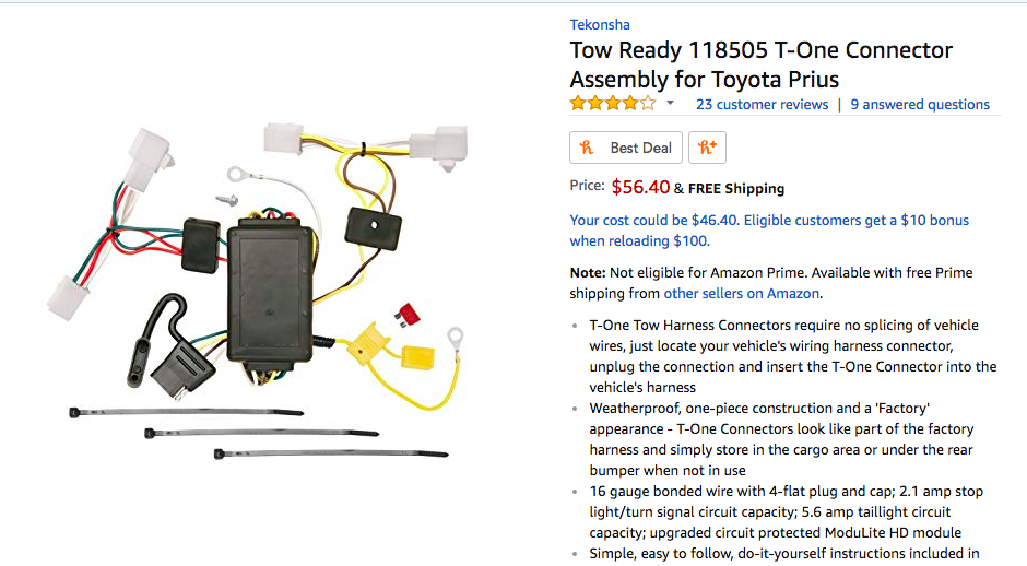

    Here is the hitch set up: there are installation videos on e-trailer and youtube.

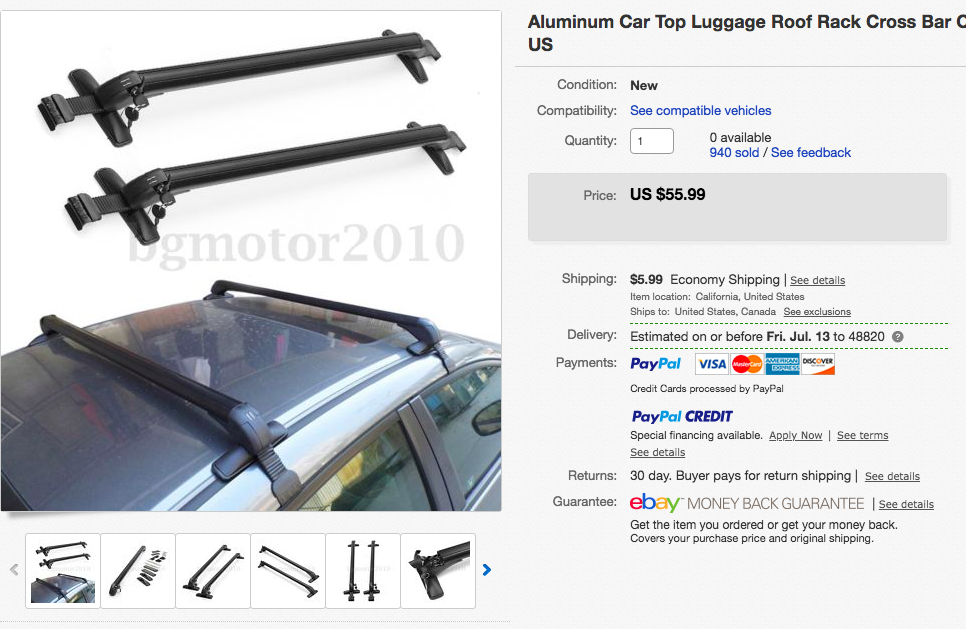

    Roof top carrier is a largest one available at Sears. We got it several years ago and have used it on many different cars including the Prius. The roorf rails for the Prius was from Ebay cheap stuff. The rails work great but do create a slight howling noise. Its funny but the noise is there only when the roof top carrier is NOT mounted. With the roof top carrier in place no noise.

    I was thinking of one of these for my kayaks. Is it safe and sturdy enough for them?

    I had no issues with my roof top carrier. But I suggest test runs at different speeds. The instructions that come with the roof rail are lousy but you will figure it out. I had to move them a couple of times to get the nose of the roof top carrier level versus pointing up.
    Maybe, a better know brand like Thule might be better but for my use I was OK going cheap.
