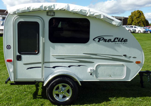

    That said, even lighter than the aluminum Teardrop Is this bad boy ......
    ..... somewhere in the 500Lb dry weight range ... but you didn't hear it from me
