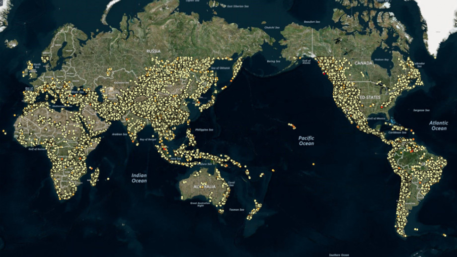

    An algorithm recently identified over half a million potential sites over the globe.
    Huge Global Study Just Smashed One of The Last Major Arguments Against Renewables
    Plenty of reason for why individual sites may not work, but we can afford to be choosy with those numbers.
    Some geological formations and old mines could also work for compressed air batteries.
