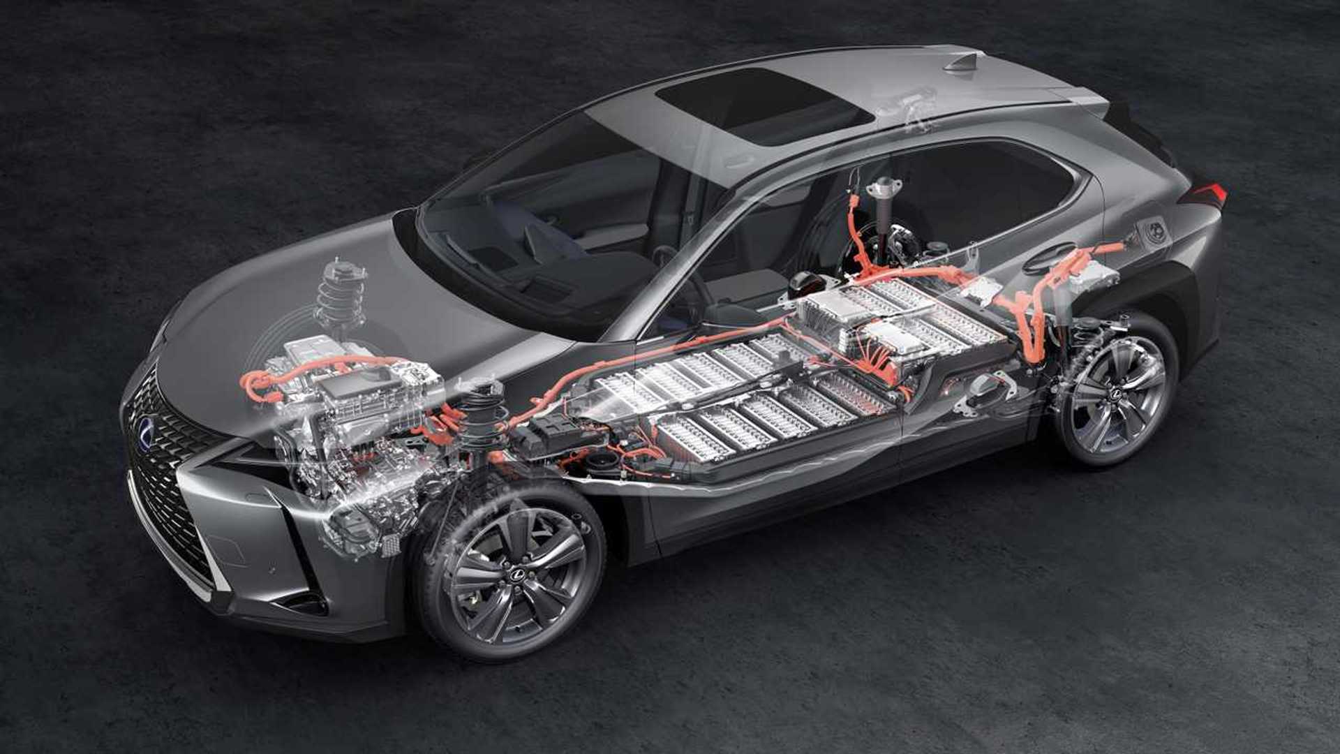

    The photo slide show reveals no radiator. The manifolds on both sides of the battery pack suggests Toyota is still using forced, air cooling/heating for their traction battery. Worse, the front engine bay is filled with a low profile motor and huge, inverter assembly that in a crash will attempt to invade the cabin. The front of the car has a huge 'radiator' inlet but there is no documented radiator.
    I am not impressed: (1) air cooling/heating batteries is less efficient than liquid cooling because it can not recycle waste heat; (2) industrial sized power electronics in front bay means no front storage; (3) stepped batteries in rear means less space, and; (4) excessive exposed high voltage cables.

    I wouldn't infer crash capability/safety out of a drawing. I'm sure Toyota/Lexus have done a good job, they have to if this Lexus will hit european and american roads.
    The high voltage cables are not much different from every other BEV, could you deepen that?
    I fully agree with you: air cooling and no front storage could be better...

    I agree on liquid cooling the batteries. Toyota already has a cooling system for the inverter so why not redesign the batteries to accommodate liquid cooling and maybe just enlarge the inverter cooling system to include the batteries. Tesla's liquid cooled batteries explains why they can use higher charging rates.
    I would expect that these models will have pretty good frontal and offset crash protection. The crush zones would be similar to an ICE engine compartment. If the impact velocity is high enough no amount of crush zone protection is going to save the occupants anyway. As a friend of mine who use to build water towers used to say about a falling, "Once you get above 30 feet, higher doesn't matter".

    These are BEV conversions of ICE cars. They will be lacking compared to one built on a dedicated BEV platform. The grill can be more blocked than the ICE one. Price is an important detail.
    Seen a photo of the battery pack. Blowers were visible at the front of it.

    Well, I've been told that this battery pack is cooled both by air and liquid.
    And the cells are NMC622.
    Can anyone confirm?
    #8 telmo744, Apr 22, 2020
  9. Trollbait
    23,743
    12,831
    The Rav4 Prime will have a cooling loop off the A/C for the battery. Don't know if it directly chills the battery or just incoming air, but it is technically a liquid at some point in the system.
    As for using both air and a liquid, under ambient conditions, cooling, wouldn't that just mean dealing with the downsides of both. There is the weight of the liquid system, and the bulk for air ducts.

    10 year/1 Million Km warranty including capacity degradation below 70%. Totally air cooled and tied to the A/C. Using pouch cells instead of cylindrical, apparently the Lexus engineers think air cooling is better for their battery and offer a warranty to back it up.

    I'm glad toyota/lexus is getting in the game. The DC charging is not much of a trick, its less than 1C @50 kw, and I bet it gets throttled down quick in hot weather. Tesla is now upgrading chargers to v3 = 250 kw which gets throttled down quickly but is 5x greater in peak charge. VW through porsche is now designing liquid cooled batteries that can take 800 kw for a short time.
    The 10 years 70% though on air cooled is more of a trick. Only time will tell. I would bet this would not work in Texas or Arizona, but cooler places are the launch for these BEVs. My tesla kicks in battery conditioning when its sitting in the hot sun, I'm not sure how well even using air conditioned air cooling will work on a parked car.
