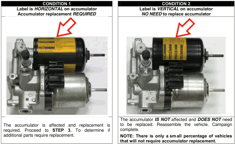

    Great, let's take a look at that notification.
    I added the highlighting. The yellow bit introduces where it tells you what the specific covered condition is. That follows in the red bit. The covered condition is internal malfunctions of the brake booster. Not the brake booster pump. The brake booster. Those are separate assemblies in a Gen 3.
    If your brake booster has the condition, you get both assemblies replaced (the bits in green). Why exactly? They don't say. But if your brake booster has had an internal leak for any length of time, that will mean your brake booster pump has been working overtime for that same length of time, keeping the pressure replenished. That wouldn't be a bad reason to replace it at the same time.
    You're replying to my correcting you when you said the booster pump assembly contained an ECU.
    Toyota's nomenclature here confuses a lot of people, some of whom even work at dealerships. If it were up to me, I would not have one part called the brake booster and a different part called the brake booster pump. The names are too similar, and people mix the parts up.
    This is what the Gen 3 brake booster assembly looks like:
    This is what the Gen 3 brake booster pump assembly looks like:
    Take a look at the first picture, the brake booster assembly. The rectangular, flat, heat-sinky area facing you is the brake/skid ECU that is built into it.
    Now take a look at the second picture, the brake booster pump assembly, which you wrote contains an ECU. You see a pump (the round silver-colored thing), an accumulator (the round black thing), a very minimal manifold with a spring-loaded relief valve, a couple hydraulic connections and not much else. You will not find an ECU there, and neither will your dealer-trained career mechanic.

    So here's what's weird about your approach. What's your priority here? To understand and resolve a problem? Or to find ways of making it sound like if you don't understand it, it must be that nobody does?
    What's with the scare quotes around "leak"? If you're unsure about "where", what would be wrong with looking at a diagram?
    Your possibilities for "where" could be the linear valves (outlined in blue), the reduction valves (outlined in gold), or the spring relief valve shown below the reservoir in the accumulator pressure line (but that one's in the "booster pump assembly", not in the "booster assembly", and really never has any reason to open in normal operation, so has little reason to wear or develop leaks).
    You do understand nobody's talking about an external, fluid leaving the system, leak, right? Leakage through the linear or reduction valves would just be sending fluid back to the reservoir, and preventing pressure from holding.
    The inside info about ZJB that we don't have is stuff like: is it one of those valves in particular that always develops the leak, or more hit or miss? Is it wear, foreign matter getting stuck there, or what? Was it designed to have a useful life of n00,000 miles but ending up leaking at (n/2)00,000 miles, or something? Is that because a supplier messed up?
