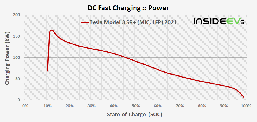

  13. Lee Jay
    Lee Jay Senior Member
    Jun 25, 2009
    5,850
    4,036
    Westminster, Colorado
    Found this charging curve for the Model 3 with LFP battery.

  14. t_newt
    t_newt Active Member
    May 27, 2018
    218
    247
    94087
    One thing that surprised me is the voltage. I think Porsche was the first car maker to have 800V batteries (most EVs use 400V). This doesn't require special batteries--it is just a different way of hooking them up in serial. There has to be switching to allow charging in 400V mode too since most DC chargers are 400V (the 350kW ones can go to 800V). There are a lot of advantages to going with 800V. The biggest is that charging speed is cut in half, which is a huge advantage with the slow charging time issue of EVs.
    I had thought that going with 800V involved high expenses for the switching until Hyundai came out with a lower-cost 800V EV, the Ioniq 5. After this, I figured that because of the huge advantage, that this would be the new standard and that any new, upcoming design would go with 800V.
    So I'm really surprised that Toyota is not going in this direction.
    Added: here's a charging curve of the Ioniq 5 vs typical 400V vehicles:
    Tideland Prius likes this.
