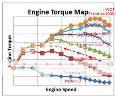

    I think that they are both correct. Take a look at the engine torque map in the figure below. When sudden acceleration occurs, the engine speed suddenly increases from A to B, causing the engine to run at its maximum speed.
    Then, when the driver applies the brakes, this puts a load on the engine which decreases the engine speed. But as the engine speed decreases, the engine torque INCREASES as shown by the change from point B to point C in the figure. The driver perceives this as pressure on the brake pedal causing a higher acceleration. This increase in acceleration when pressing the brake pedal has been noted by many drivers during a sudden unintended acceleration incident. The same effect occurs during dynamometer testing, when the throttle is opened a given amount causing the engine to go to a maximum RPM due to the absence of a load (or with only engine and drive train friction as a minimal load), after which placing increasing loads on the engine causes the RPM to fall and the measured engine torque to increase. This is how the engine torque map is produced and measured.
    Normally, when the engine is not undergoing sudden acceleration, the engine speed is to the left of the maximum torque for any given throttle setting. In this case, the engine torque will DECREASE as the engine speed decreases, and the driver will NOT perceive that applying the brake causes the engine to accelerate.
    Therefore, the speed of the engine during brake testing is very important, because at high engine speeds the engine will be fighting the brakes, while at low engine speeds the engine will not be fighting the brakes.
