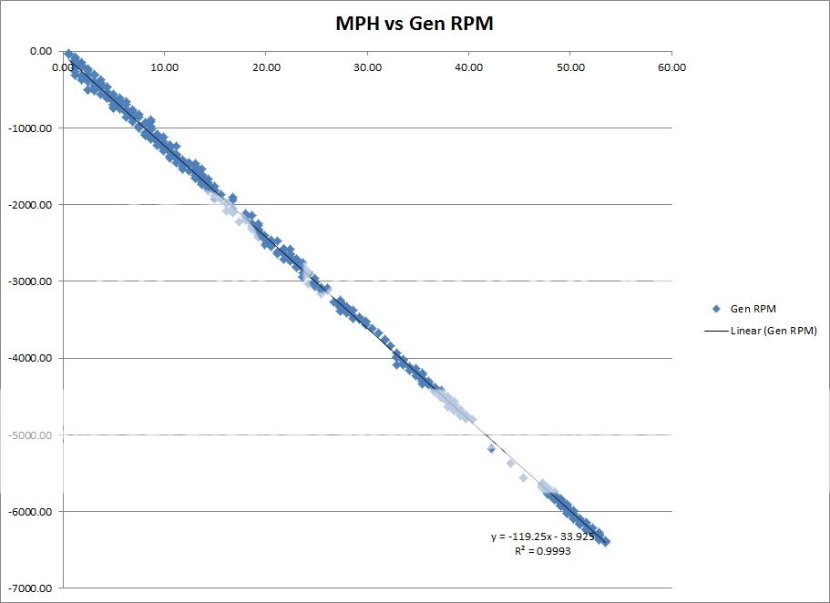

    Here is the chart:

    The Generator RPM is variable when the ICE is on. There is not a fixed ratio of Gen RPM to ICE RPM. It all depends how much of the ICE torque is going to the wheels versus going to the generator. The FFH likes to charge the battery with about 30-40 amps of current (8700-11,600 watts @ 290 volts). The Generator RPM can be as low as 30-50 RPM and still put 30-40 amps into the HVB. When this happens, nearly 100% of the electricity from the generator must be flowing to the HVB and almost 0% of it must be going to the traction motor. In city driving the Gen RPM is often 5000-6000 because the ICE is sending almost 0% of its torque to the wheels. In city driving the ICE primarily only spins the generator and then the generator sends some electricity to the battery and some to the traction motor to power the wheels. In typical highway driving there is a split of the ICE torque and the Gen RPM is usually 1000-2500 depending on how the car decides to split the power.

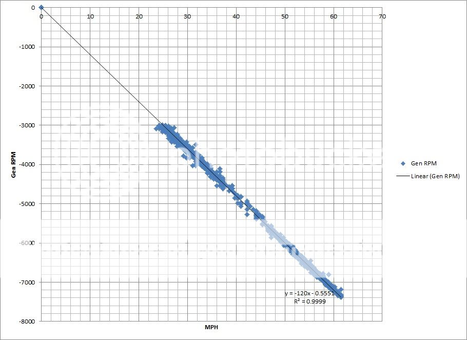

  14. hybridbear
    hybridbear Member
    Aug 19, 2013
    267
    69
    Minneapolis
    Here is the equation based on the 3000 or so data points from a couple trips plus another 10,000 or so data points of (0,0) to get the equation to pass through that point or as close as possible since that's the one data point that we actually know is correct:
    Gen RPM = -120*MPH
    Note that in theory the intercept should be exactly 0 because when speed is 0 the Gen RPM is also 0. But this is very close to 0 and can probably just be ignored as noise. It's very hard to get the measurements exactly in sync which creates noise in the data.
    This means that the previous FFH max Gen RPM was: -7440 @ 62 MPH
    Now the max Gen RPM is: -10,200 @ 85 MPH
    Here is the chart:
