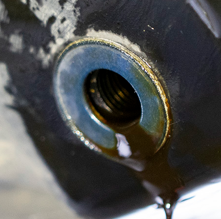

    Changed engine oil, the drain plug was really tight and had to use a breaker bar, but the more surprise was that the workshop did not use a washer last time. At first I thought the blue bit is the washer but I was convinced that it's part of the sump. I have looked, there's no washer in the oil pan, and no washer on the drain plug.

    Blue Loctite?

    I think the blue residue is the felt material left from earlier washers.
  18. Mendel Leisk
    61,574
    42,364
    ^ That's the washer, stuck to the oil pan. If you haven't buttoned things up already: put a slim flat-blade against the edge, give a gentle tap with a hammer.

    My goodness! I had a suspicion that's the washer but couldn't get it off using a flat headed screw driver, though I didn't try very hard.
    Now there are 2 washers. Until now the car was dealer serviced, but I dragged it out due to cost, I will be changing oil more regularly and will deal with the washers soon.

    My usual approach is to stick the slim flat-blade at a low angle into the washer - you can see how there's a little space there between the washer's inner opening and the threads behind it, so you can get the little flat-blade behind it there with no risk to the threads if you're paying attention. Then just pop it off. I've never needed a hammer.
