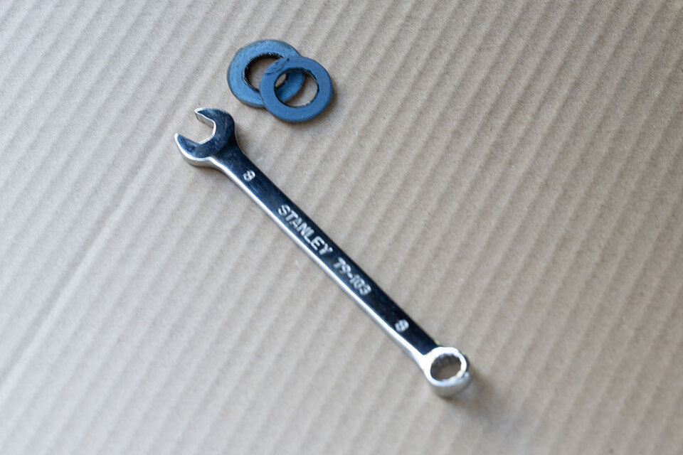

    Finally did another oil change, I know should have done it sooner. 13,000km or 8,000mi over 3 years.
    Indeed the previous washer was present, the second washer also stuck on there. This time I'm 100% sure because I put one there last time.
    Using an open ended wrench did the trick, sort of pry from the centre.

    Did what trick, breaking loosen the old washer? I find a slim, flat-bladed screw driver blade, tapped in with a hammer, jars it loose. Typically do that as soon as the drain bolt is backed out a few turns, less messy.

    Yeah to get the old washers unstuck. I tried using a plastic scraper, then moved up to a flat screw driver without too much force, unsuccessfully. Guess was being overly cautious. Using a small screw driver to pry from the centre would have the same effect as the wrench, but wrench is easier to leverage.

    For stuck washers I use an old/dull flat blade screwdriver, and try to place it on the edge of the washer above the metal so that it won't scrape when it moves. Flat of blade parallel to the metal surface. Push on the washer lightly with the screwdriver until it grips and then with one finger underneath apply a tiny bit of outward (with respect to the metal) force. Usually the screwdriver hangs up on the washer and doesn't actually move at that point, but it is primed to. Finally a very light tap with a hammer or the side of a wrench with the other hand on the back of the screwdriver and the washer always flies off while the tip of the screwdriver moves away from the metal at the same time due to that preexisting force.
    It is amazing how little impulse is needed to remove a washer this way, whereas pushing on it with a finger almost never makes the washer release.

    May be it's the felt like coating makes it stick. Never experienced this using crush washers, the kind that deforms after tightening.
