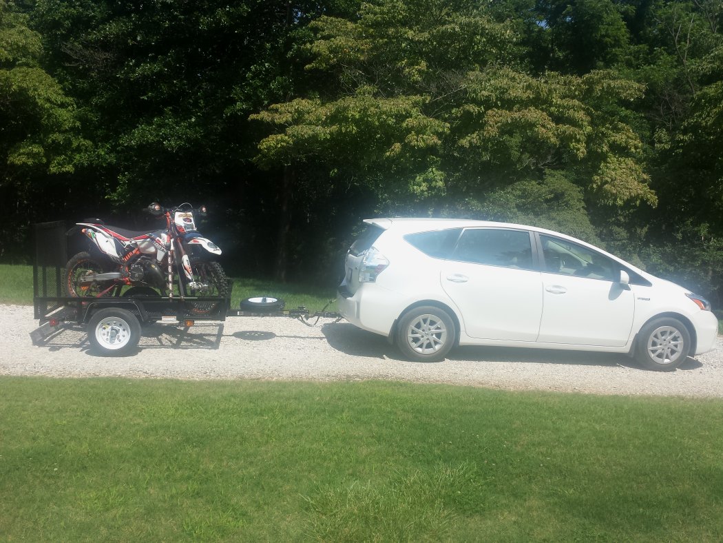

    I installed my TorqLift Eco Hitch today. Was a pretty easy job and is very well hidden. They did a nice job on it.
    Going to tow my dirt bike with it tomorrow on a 4x6 trailer. Counting my weight, the total of everything will be just below the max cargo capacity, so not expecting any problems.

    No problem on my first tow. Was about 60 miles each way, about half in town, half rolling 55mph roads through the Ozark Mts. I put in PWR mode for most of the trip. Ran the AC on the way home, as it was in the low 90's yesterday. I reset one of the trip meters for the trip and it indicated 39.4mpg for the trip. Hard to say how accurate that is, but I'm sure its in the ballpark. I make this trip fairly often, so this is going to save me a lot of money over the same trips with my 3/4ton Suburban that gets 13mpg at best!
    Anyway, very happy with the hitch. Here's a picture of the setup. I've had a heck of a time getting pictures of this pearl white paint job in the sun, so apologies for the over exposure.
