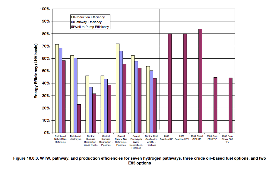

    Unfortunately, however, the graph only shows fuel energy conversion costs. It doesn't include additional energy costs of the vehicle propulsion systems or fuel infrastructure.
    As noted, they have to overcome both cost and durability issues. HFCVs are still just a research project. Even though they continue to make improvements there are fundamental market problems for HFCV:

    It is not just conversion loss. Well-to-tank includes drilling, refining, transportation, etc. Tank-to-wheel includes all the loss in the propulsion system.

    Although that is a pretty graph, it doesn't really match existing vehicles as has been pointed out previously.
    Toyota uses an idealized version of current hydrogen refueling stations and assumes future ones will become much more effient. It then assumes a more efficient than currently available fcv. For BEV and PHEV though doesn't give today's tech but yesterdays. This is an old chart.
    So what can we do? We could use EPA for real world things.

    make assumptions on well to pump and to wall. If you are using the 2025 hope of hydrogen use projections for the grid for them, or you can use today for both.
    On the California mix of hydrogen stations and electricity that Tesla should be at least 20% more efficient than the clarity. Lots of folks willing to pony up 50 large for a fuel cell car will also be likely to put in solar or buy wind. On newables the Tesla is more than twice as efficient as a clarity. How many people do you think with choose a $50K fcv over a $60K Tesla S 60kwh, that likely is much more luxurious, faster, more comfortable, and they can refill at home for less money. Most people won't be able to afford that tesla, but will be able to buy a gen IV prius phv or other phev car. It should also be more efficient on electricity than a fuel cell vehicle. That is why I would not expect fuel cell adoption until they also have at least 15 miles of plug in range.
    Drop in your own assumptions for grid efficiency and improvements in phev, bev, and fcv efficiency. I would bet the gen IV prius phv gets an efficiency boost as well.

    Well to tank does NOT include drilling or exploration.. it includes puming from the well, refining and tranport to stations. It also excludes the energy for the fueling stations.
    What are the assumptions in the H2 production.. I can find no data with that level of efficiency Here is the most recent data from NREL on well-to-pump efficiencies of different H2 production Pipelines.
    From this report
    http://www.nrel.gov/docs/fy10osti/46612.pdf
    Which is at best 59% efficient for NG reformation.
    With respect to infrastructure.. we already have Elect infrastruture.. so its marginal energy investment is very small. H2 is all new costs.
