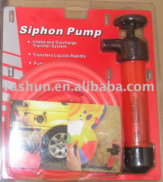

    They do have the pump online, here's the name of it. "mityvac fluid transfer pump P/N 07240", just type that on ebay search list and it'll show up. Also here's a similar picture of it.

    I bought mine from Harbor Freight for around $5.00 and threw it away. They work but are by no means a well built tool.

    That's why I don't buy any special tools at harbor freight. I bought my pump from Matco Tools, it works better than harbor freight.

    They are identical. Same package, picture, you just paid too much.

    My buddy who bought the exact same pump from harbor freight, he said his is more loose than mine and the material is cheap. He said mine felt more sturdy and stiff when he was using it to pump the fluids.
    I know I've overpaid for it, but you get what you paid for. I know harbor freight has the same design for the same higher end stores, but for some reason, I feel that their product is more of a cheaper end. I know for a fact that they copy or buy other patent products with similar design at a low cost, that's how they can sell it for so cheap. Just like one of my 0 off-set long wrench I bought from them 6 years ago, they stopped selling because it was the same design as Matco Tools. I don't know exactly why HF discontinue the wrench, but that wrench felt cheap and light, and not as sturdy and heavy as the Matcotools one.
    All in all, its where you buy it at, I know I would buy Harbor freight sockets because if it breaks, it's cheaper than the matcotools or snap-on and some sockets rarely break. But I would never trust specialty tools from harbor freight.
    I will let you know when my pump breaks, since I did over paid for it and seems like its still working for me :)
