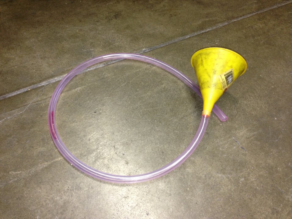

    I change mine today after 2 years and 5 months @ 77K+ miles, the ATF smell very bad, the used fluid turn dark purple, the smell hard to described, I have a buddy(strong arm guy) assist to break loose both fill and drain nut, he did the dirty works, I only help pour in with a funnel and about 3 feet 3/8 size clear plastic tube, drained out 3.25 quarts and put back 3.5 quart, no fluid overflow out yet until I added another 1/8 quart then it just barely overflow out, so 3.5 quarts is correct amount.
    Test drive after everything put back and the car feel a lot smoother and quiet, the transition between EV and engine assist barely noticeable, I don't notice anymore gear groaning/grinding noise at slow pickup speed about 5 MPH, overall result is very satisfied, will see any increase in MPG later on next week, my daily commute about 150 miles round trip daily and there are many start/stop trips.
    Toyota dealership charge almost $3 on the washer (highway robbery) ATF-WS like $12 plus local tax, when I go to dealership get the oil and washer, the part counter guy kind of like laughing at me said "You shouldn't change it yourself because it's lifetime...!!" then I told him about it is serviceable because I read on the service manual, then he said..."how do you determine the level, they need to hook to a tool to read the temperature to determine the fluid level." I think they BS me, but anyway...I bought the fluid and washer and left, why argued!! This a dealership in city of Palo Alto California.
    So...I suggest that if any Prius owner wants to change the ATF fluid should have a friend help pouring the fluid using the "funnel - tube" method, it works and less messy.

    This is what I used... IMG_1156.JPG to fill the ATF fluid from top passenger side down, you can see and access the filler plug after open the oil change access panel, no need to remove the entire under panel. It took about 30 - 45 minutes at most.
