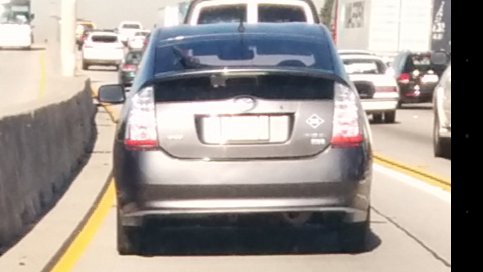

    I saw a Gen 2 Prius on the 91 Freeway in Orange County, California, with a CNG sticker the other day. It did not have White HOV Stickers so I assumed it was a joke, but then it got me wondering if having that CNG sticker is a requirement for a CNG conversion car. Are people actually starting to convert their Prius's to CNG? Or is this still a handful of people venturing into these projects? cng_prius.png

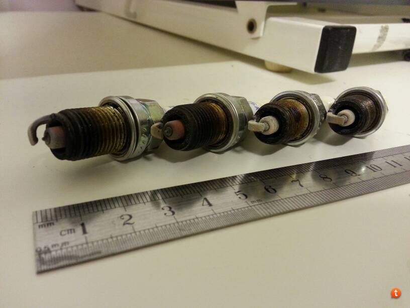

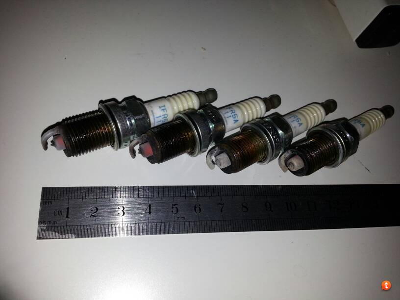

    I removed spark plugs yesterday. they were burnt out. Grumpy is correct. Temperature plays its role here.

    Photos of spark plugs?
    Would it be helpful to install spark plugs that run a cooler heat range? The correct Denso plug is SK16R11 but it appears that it is possible to order plugs that run up to 34. Maybe the 20 or 22 would be better if offered in the size that will fit Prius. See the sixth FAQ below.

    Patrick, It's 2am here.
    I will go to the car and take the old spark plugs.

    Do you know which cylinders the first two plugs on the left came from? I am wondering why they have reddish deposits vs the last two plugs whose insulators are white.
    Does the LPG warranty cover damage to the gasoline engine itself?
    Do you have instrumentation that allows you to monitor engine cylinder head coolant temperature as you are driving the car? If so, what is the operating temp of the engine?
