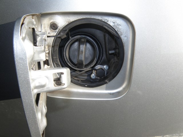

    1 adapter to re-fill LPG (as the filling cap is hidden inside the fuel cap)

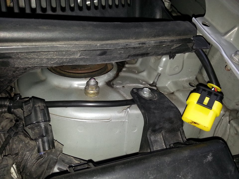

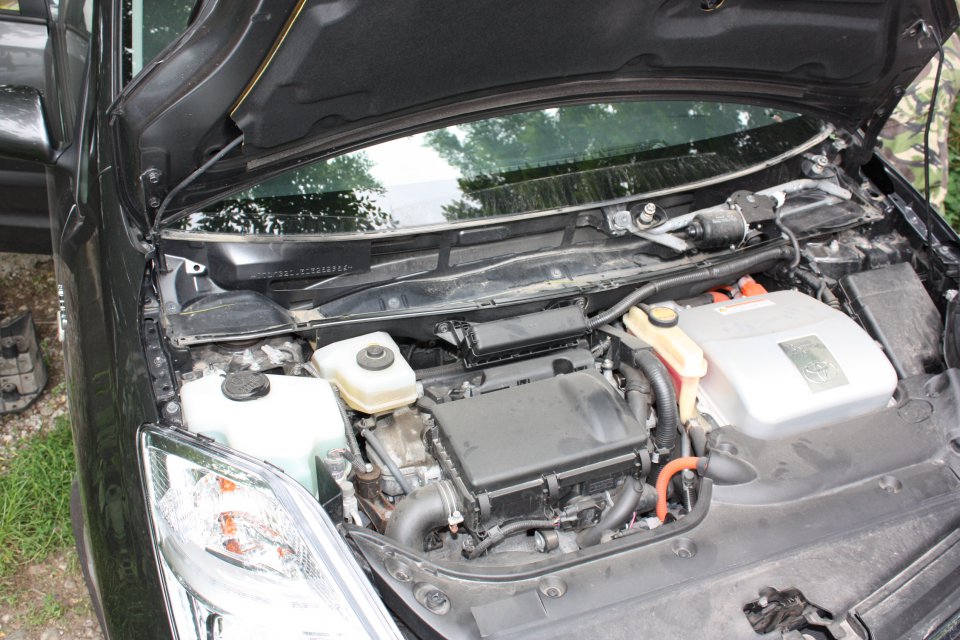

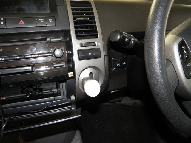

  4. Agape
    Agape Member
    Nov 1, 2010
    378
    Ireland/Eire
  5. 2007blueprius
    2007blueprius Member
    Dec 26, 2012
    466
    looks good, glad to hear a 600 mm tank fits, the propane tanks are built to only be filled to 80 % not so much for regulations but safety, it needs to have some room for expansion in case of high temperatures so it does not blow up, the multivalve has a overfill valve built in, very clean instalation, can't even see where the reducer went nor the controller, one thing I can honestly tell you I don't like at all is the way the injectors were installed, rather ingenious I'll give the installer that, however they are upside down, absolute no no I'm told, lpg has some waxes/lube added to it in order to lubricate the fill pumps, the injectors are supposed to flow downward, and be located above the manifold nozles so that the waxes can flow downward into the intake and burn away, not sure how long it will take for them to get pluged up but they will be sooner than normal, they should have been at least at a slight angle downward, this is the absolute worst way to do it. keep in mind I don't have experience with it but thats what I read on several sources. also not sure how well would they do sandwiched between intake and motor, the prius does not get too hot but that is one of the hottest spots in the engine bay.
    what happened with the valve lube kit? did you still get it.
    if it's not too much trouble I'm curious to see where they put it as well as the controller, or what size nozle they used, I'm told this last one is very important but I have not yet found any sources regarding selecting the proper size, it's supposed to differ based on the injector selected as well as the engine size/hp mostly.

  10. Agape
    Agape Member
    Nov 1, 2010
    378
    Ireland/Eire
    I strongly suggest to buy sound proof material (sticky one like for the engine bonnets) the multivalve and electro-valve (at the tank and at the engine bay) together In conjuction sounds like a broken piano with metal parts, this is like a resonance box. The only downfall of this install, however this isn't noticable at highway or country roads, it is only annoying at traffic with start / stop function.
    I still don't know where is the controller :) the installer hide it from me. :)
    please mention to your guy that you will also require mounting plates for each components and ask to supply these or otherwise you will need to have visit to hardware shop to get these. I may ask installer whether these comes in the box with other parts or if sold separately. Let me know if u want me to ask this question.

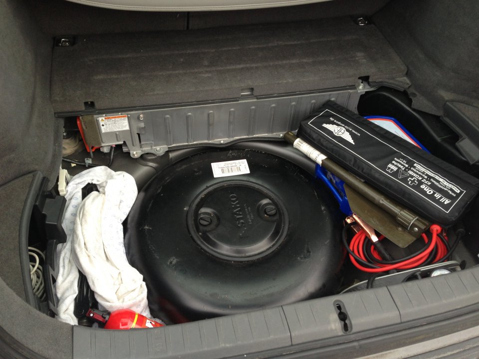

    Bear in mind to get the LPG tank as high as you can get, 600mm will fit (all you need to do is to slightly bend (or remove one bolt) from the outer casing of the HV battery cover (that is it really).
    The more LPG you can get into the tank the better for your range 600mm by 270mm I think would be the biggest but try to find bigger if you can.
    The biggest tank I found:
    600mm x 300mm - capacily 67,5liters (less 20%, so 54liters of actual capacity)

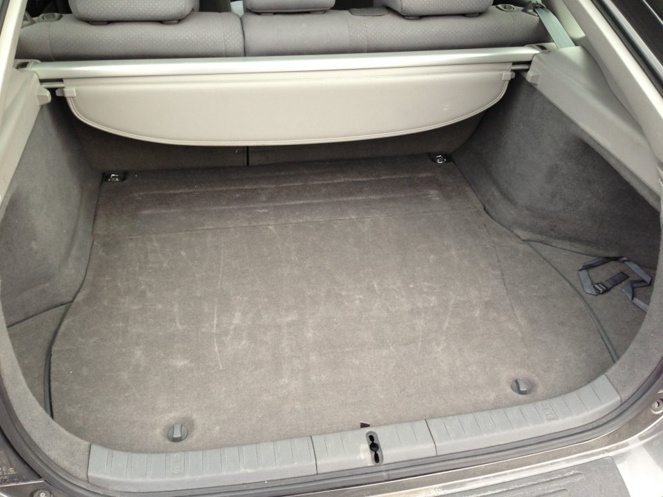

  15. mandrei83
    mandrei83 Member
    May 14, 2009
    139
    32
    Stockholm, Sweden

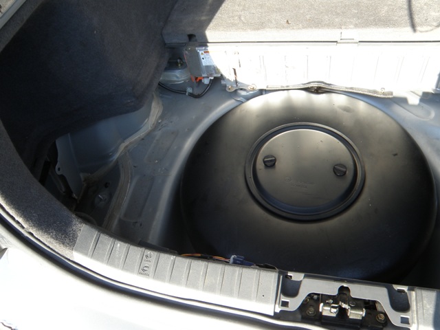

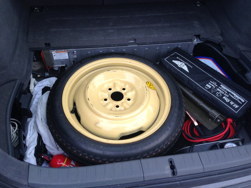

    Here is my LPG tank installed in the back trunk.
    I have to admit that this car was made for such a LPG conversion: the 180mm tank has over it the back-up small-size wheel and the cover of the trunk gets over both perfectly! The cover it's a little bit upper, but there's no problem, because over it I have a trunk tray (not shown in pics).
    So, no need to complicate things and to cut the inside plastic trunk (between the LPG tank and the upper trunk tray). Just throw away the plastic trunk and that's all... IMG_0700.JPG IMG_0701.JPG IMG_0702.JPG
  16. 2007blueprius
    Dec 26, 2012
    466
    looking at Andrei's pictures that 580mm tank is a snug fit allready, unfortunately for me such a tank was not a good option, in short it would cost me more to run on propane than gas, its a region thing, gasoline is $3.5/gal, fill stations for such a tank few and far in between and aprox $3.35/gal, sonsidering the more fuel burnt per mile I would actualy pay more to run on propane, I stock propane at work in standard 33lbs tanks and I get it for $2.5 per galon same place that refills my tanks would refill one of these tanks for $2.9/galon times that by 1.3 to match gasoline comes up to $3.77/petrolequivalent, that is the cheapest in my area and the only one that is reasonable yet still more expensive than running on petrol, I have other motivations obviously, as it is I would only be saving a couple bucks a week, one of those calculators said it should pay off in 44 months, that's just the kit cost, not counting labour.

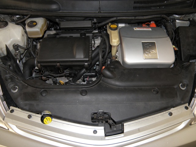

  18. mandrei83
    mandrei83 Member
    May 14, 2009
    139
    32
    Stockholm, Sweden

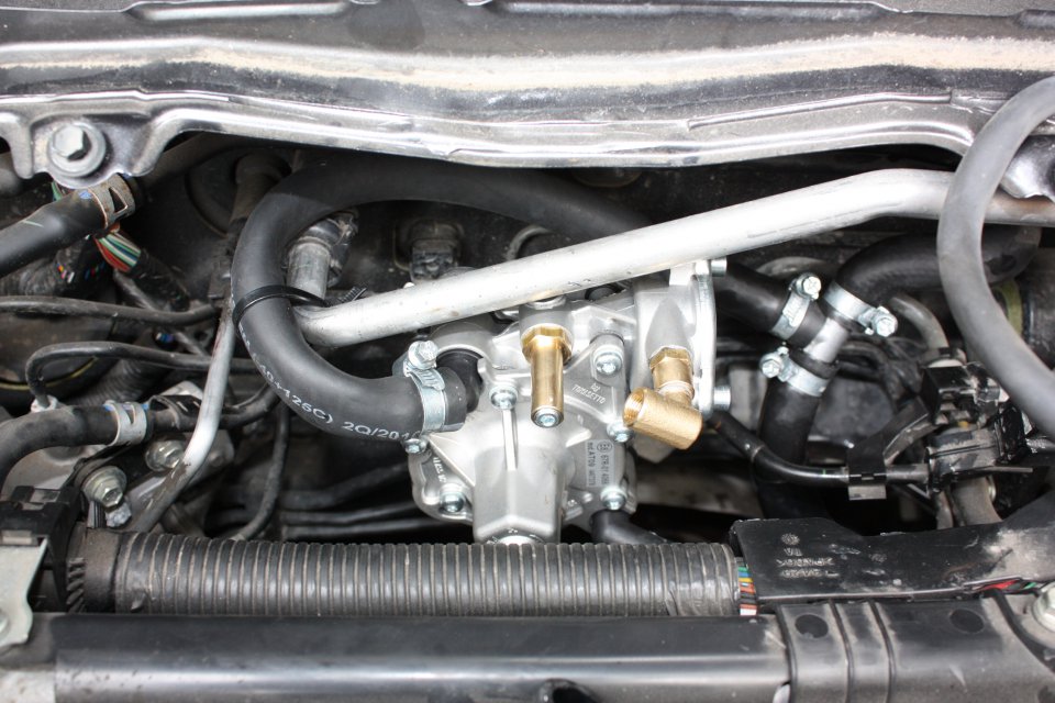

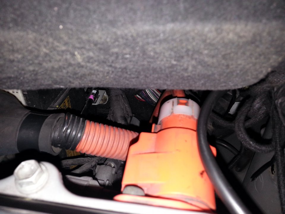

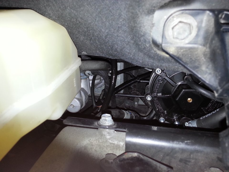

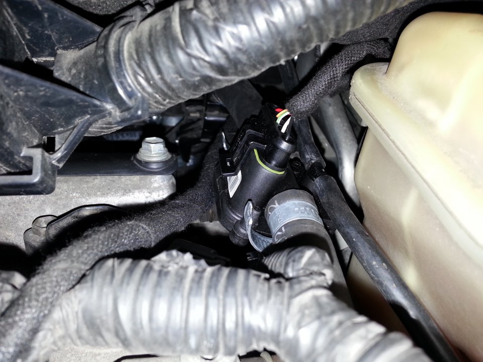

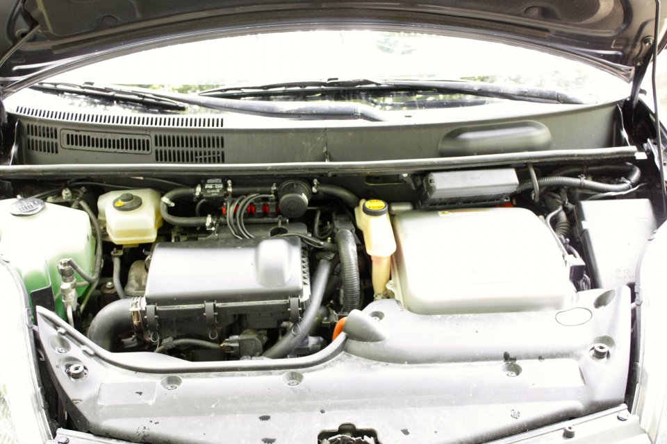

    Indeed, my installation guy knew what he was doing. As an idea, here is before the installation how my car looks like:
    On my final installation, you can see that the relay from the top was moved from left to right, in order to make place to the injectors, filter and wirings. The LPG ECU was mounted between the HV module/engine and the inverter water pump/big relay box with fuses, on the right side.

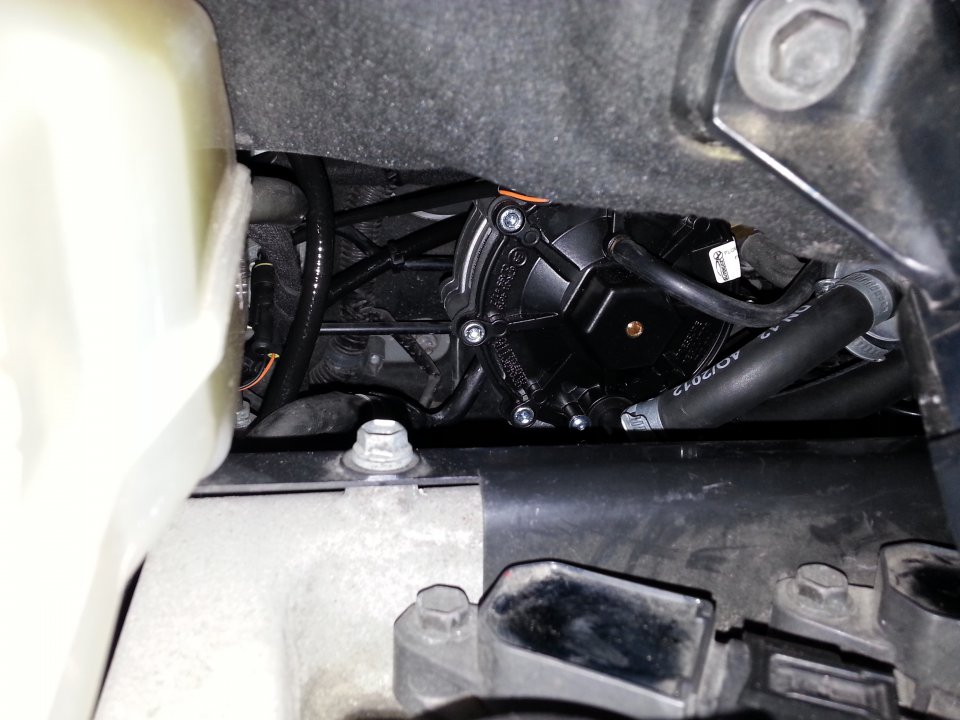

    The place where this little monster has found his place was under the front wipers, after dismantling both wipers, along with the wiper engines... so he could stick his hands inside. Looks complicated, but that was the only place where he could stick the vaporiser.

  20. 2007blueprius
    Dec 26, 2012
    466
    I can't figure out where the vaporiser went I see the upclose pic looks like on the firewall somewhere but not on the big picture
