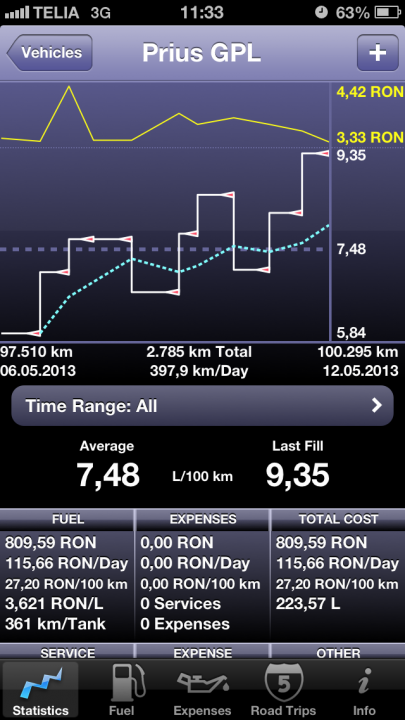

    So, finally, driving on highways around 2800Km on LPG and a cost of 809RON/240USD/185EUR = isn't so bad... A Honda 1.8 engine takes 8 liters of gasoline (or maybe more) / 100Km and would consume around 224 liters for 2800Km, meaning a cost of around 1400RON/416USD/320EUR (assuming that the gasoline cost is 1.5EUR/liter).
    From the picture, note also that a 32l tank (filled with 27l of LPG) during the driving on highway in aggressive style, it gets empty in around 370Km!
