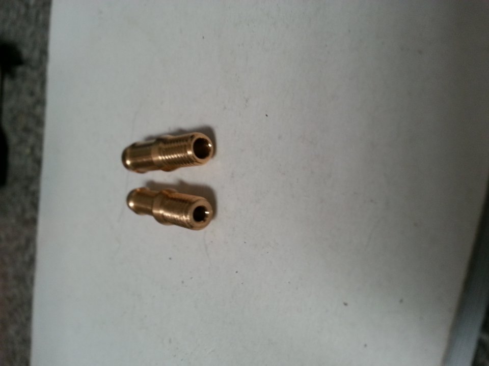

    Regarding injectors, the shorter the rubber gas pipes the better for the timing in which gas is injected to cylinders, the length of rubber pipes at mines is about 10cm or less while others I have seen are close to 30cm. Is there anything I can do to prevent from clogging the nozzles or it is just too late? I will ask on Monday about the inner diameter size or whether they just used what was in the box.

    I agree with the hoses from injector to spuds, the shorter the better also it helps if they are all same lenght, in that aspect I think its pretty cool the way they did it, the injectors and the spuds pointing up not so much, I plan on doing something simmilar but from the top, I think it's not worth changing it at this point, I would want to know how many filters you have and where are they, that solenoid valve in the video has a built in liquid filter, there is also a vapor state filter, it's sugested to change them every 15 000 clicks I believe, in your case you best stick with it, the cartriges are cheap.

    that kit is cheap, certainly a lot cheaper than a half dozen injector rails,

    here are some fittings I don't quite understand, the Drypa website translates to a degree, but that is not what got me confused, for example: AKCESORIA - Nakrętki - Nakrętka 1/2UNF - fi6mm/17mm/-731
    The "1/2 unf" that sounds like an American standard measurement, around here common fitting descriptions are say 1/2 (inch) MIP/FIP, I don't even know exactly what they stand for, it's different size threads, and a 1/2MIP is very different than a half FIP, they measure inches in different ways around here makes it very confusing, you need a degree to be a plummer, took me a while to get used to it and now I am no good in either standard system nor metric, to me those fittings appear to have a Standard thread yet they are for a metric pipe and they appear to be for a flared type end rather than a compression fitting,
    My tomassetto Alaska has a inlet that is M10x1 I believe thread and it is for a 6 mm copper pipe compression. I have to figure out how to go about it at the other end and go from a 6mm pipe to a American standard type fitting.
    Accessories-Elbows- Elbow (G1/4-G1/4/-/90) infusion this is an elbow I was talking about I don't know that G1/4 stands for, could it be 1/4 inch?
    here is one elbow that I think is right down my alley : (ID: 608) Accessories-Elbows- Elbow (M10x1-Z/G1/4-W/90) wielozaworu
    I believe the M10x1 is the male end and it will fit perfectly into my evaporator inlet instead of the provided 6mm pipe compression fitting provided, and the Z/G1/4 I want to believe it's a female end similar to the metric one on the reducer but for a 1/4 inch standard pipe, aprox 6.2mm, which I can easily source here all sorts of components for and something like this would do the transition from a 6mm pipe fitting to a 1/4 inch pipe fitting, they are cheap enough and my friend can bring me come over or I can order them but I do not know what exactly am I looking at,
    have you seen my other posts? I have a little ways to go before I get to that, right now I am working on freeing up some room under the hood so I can install the LPG components in a manner that I am comfortable with not space permitting, granted I am trying to accomplish a little more than just a conversion and no installer can go that far to modify a customers car, but that's why I prefer to take a stab at it myself.
    (ID: 432) Accessories-Elbows- Elbow (M10x1-Z/G1/4-/90) nyplowe this one appears to be the same thing but a male fitting instead, and the nuts I posted first likely thread in onto the 1/4 inch side, and a 1/4 inch copper pipe with compression fitting can go there?
    (ID: 1616) Accessories-Elbows- Elbow (M10x1-Z/G1/4-/90) wielozaworu kpl., I think this is exactly what I need looks like the m 10 male is a perfect fit on the reducer, and the 1/4 inch end is for a Standard pipe, which I should not have to much trouble to go from that to one of those flexhoses you posted to a tank, and all the safety devices I can buy here are all American Standard, should not have a problem incorporating, I do have to go tho a supply warehouse and see what they have to work with, best yet, hold off on this till I find out what can I get here for the back end.
    a closer look at the description appears this elbow is a transit from 6mm pipe to 8 mm pipe not exactly what I was looking for, I may have to make my own, drill and tap
    www.drypa.pl/produkt3386_WOZKI_WIDLOWE_-_Czesci_Impco_-__-_RK-Cobra_1_4-18NPT_10x1mm_Redukcja_reduktora_.html - Translator
    I think this is more like what I need just the other way around, this is for European pipe to go to US style reducer
