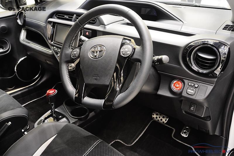

    Hi Guys ,
    I just bought a Toyota Prius C G Gs (Also Known as Toyota Aqua G Gs). All G Gs model should have the Steering wheel Multipurpose Button. On my model its missing. Can you suggest me a place online where i can buy it like in the pic below :-[​IMG]
    Regards
    Hartish

    Hii Guys,
    This is how the interior of the car look like as show n below. Can i upgrade it to add the multi function steering wheel switches? 26971908_10214208638077336_1172829545_o.jpg

    i have no idea, but the schematic might show if the wires are in there. you can get it on toyota tech info .com. if they are, it would then be a matter of finding a replacement steering wheel i would think.
    all the best!(y)

    If the car didn't come with the steering wheel buttons, there's a lot more to it than just changing the steering wheel. Almost certainly all of the modules that work with the buttons need to be programmed at that level.

    These JDM cars come in different configurations. The Multimedia steering/ push start/ Navi /Reverse Camera etc are options that the Japanese buyer specifies at the time of ordering his car.
    Coming back to Hartish car, you can have the multimedia switches installed, but you will also require the clock spring with additional contacts to get it working. Its a simple install, contact shops selling car dvd player etc.
