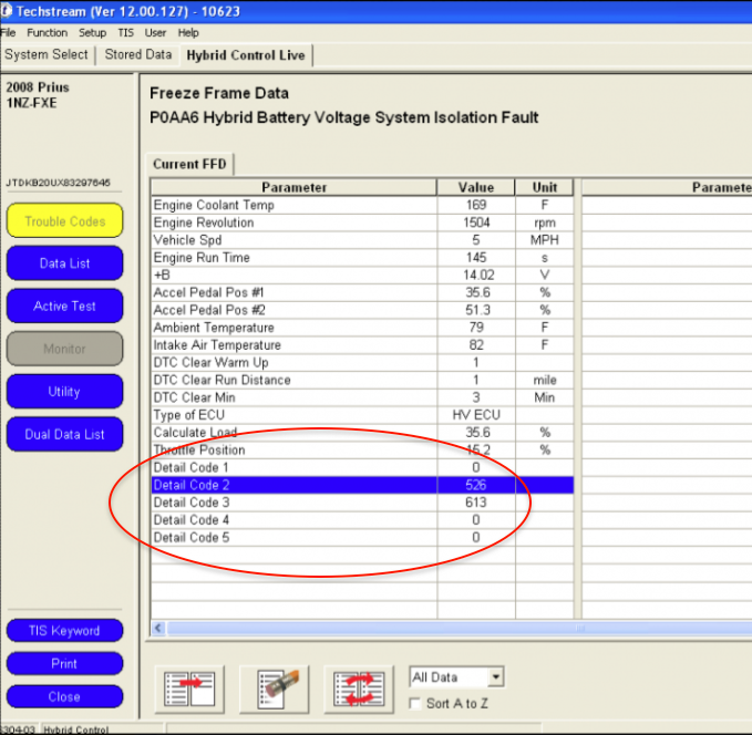

  14. SFO
    SFO Senior Member
    Feb 7, 2017
    5,302
    4,252
    Northern California

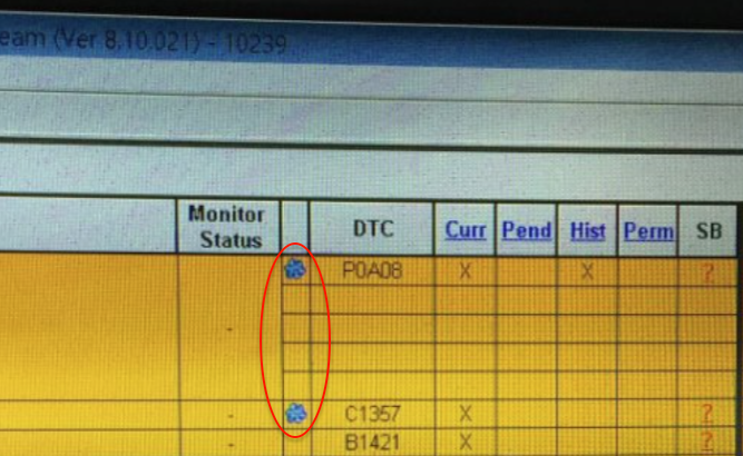

    Knowing the freeze frame data or INF for a DTC may help narrow down the issue; not all DTCs have associated INFs (detail codes)
    Were you able to retrieve the INFs or subcode(s) for DTC P0AA6 by clicking on the bluish snowflake icon?
    The gen3 and gen4 manuals are in the wild for DLing, but are not currently hyperlinked like the gen2.
  15. Debo160
    Debo160 Junior Member
    Oct 9, 2016
    MORTH CAROLINA
    ----USA----
    Ok the detail codes are: 526 and 614

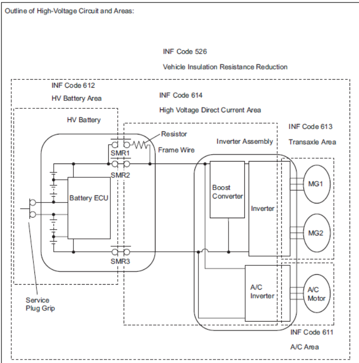

  16. ChapmanF
    28,747
    19,054
    You can (roughly) refer to this (Gen 2 Gen 2 Gen 2) diagram to see the area of high-voltage connections to look in for a leak identified with a 614 code. I haven't found an equally nice diagram for Gen 3.
    There are a few changed details between generations, and Gen 3 doesn't have an A/C Inverter section inside the inverter assembly, but otherwise, this roughly shows what you're looking at.

  19. ChapmanF
    28,747
    19,054
    Do you have a megger to test for leaks with? That would be a whole lot less invasive than pulling the compressor and experimenting with reflowing stuff.
    In a Gen 3, I guess I can kinda sorta believe the compressor could be implicated with a 614 code. Because the Gen 3 compressor inverter circuitry is inside the compressor (in Gen 2 it was in the inverter assembly), even though leakage in the compressor motor windings would still give you 611, the Gen 3 cable to the compressor, and the input side of the compressor's built-in inverter, would still be part of the 614 area.
    I'd call the transmission more of a long shot. You should really have a 613 if it's that.
