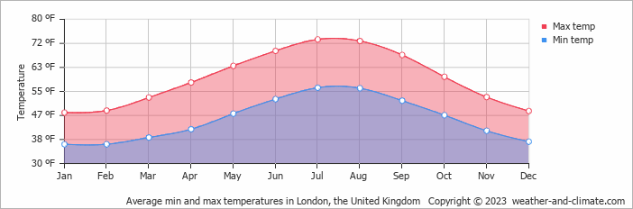

    considering most of UK temps - i'd be hard pressed to worry about high towing temp's

    It's worth noting that that 725 kg tow rating applies Europe-wide, though, and there's much hotter areas than the UK.
