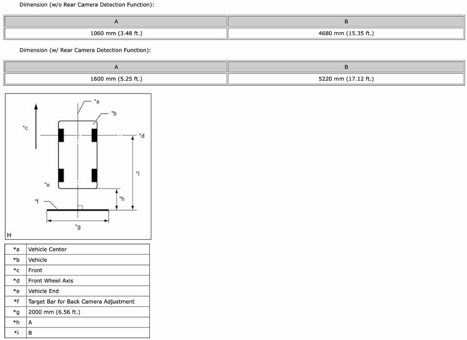

    Here are some details that may help solve this mystery.
    From TIS there are two different calibration areas based on which rear camera is installed. Here is a screenshot.
