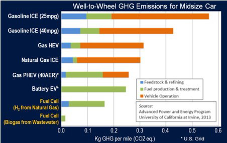

    This is some great info.
    Here is how I see it:
    As others have mentioned, hybrids are inevitable, and we're going to to see a LOT of electrification as we head towards 2025 CAFE.
    That leaves open the question of the future of the ICE. There are some trade-offs in FC's vs. ICE, and it comes down to how low they can get FC costs in terms of $/kw. I think the target is $30/kw, and I will admit a lot of progress has been made in the past decade (as I mentioned, whether this money could have achieved more with other tech is a valid question).
    Well, $30/kw for a 100kw fuel fell (134 horsepower) is more than sufficient for a mid-size sedan or small SUV, once you factor in the added power provided by the battery.
    So, we are looking at $3000, which is within the ballpark of what a v6 engine costs. But the problem as I see it is WARM-UP time, and it is here that FC's need to improve, or be forgotten once and for all as a contender.
    Two reasons:
    (1) With a warm-up time of 15-20 minutes, you need a battery big and powerful (and expensive) enough to provide 20 miles of range. On a Cadillac Escalade, that would mean 10kwh available (and up to twice that in nominal capacity, assuming 50% DoD like the Volt pack); on a Mitsubishi iMiev, it could be 4kwh (up to 8 kwh nominal)
    So, between 4kwh and 20kwh, we are looking at between $1200 and $8000 added to the cost of the fuel cell. If they could reduce warm-up time down to 7-10 minutes (requiring 10 miles max EV range), then you can cut that down to between $600 to $4000.....which might be 'reasonable'......at any rate, it appears to me that FC developers would be better off reducing warmup time (and thus battery requirements) as a cost-reduction measure as opposed to cutting costs of the FC stack itself (through better catalysts, etc.)
    (2) The conundrum the FC faces is that the battery is NOT there to provide power, it is there to provide RANGE during FC warm-up. In fact, the ideal situation for a FC (and probably what Toyota is hoping for) is that the price drops to what an ICE is, while simultaneously achieving a comparable warmup time. In that case, the FC would be sized only for continuous power, while a Prius-size battery would be more than sufficient to supplement it for peak power. (Of course this still leaves open the question of infrastructure). But if FC stack costs drop -and warm-up time doesn't- then you will need to make every FCV a PHEV-10 or PHEV-20. That means that the FC will rarely be called upon, and if it's selling at a premium to the ICE (which I guarantee it will when first introduced; they will definitely not wait for parity before commercialization), it will take that much longer to recover the up-front costs.
    It is no different than how a hybrid driver will recover their premium much more slowly if the do exclusive highway driving and how a diesel driver will recover their premium much more slowly if they do exclusive city driving.
    Anyhow it will be really interesting to see if the FCV's have a plug or not. As you said, it would help with hot and cold days, but it demonstrates the superiority of the plug, so I think a FCV maker would be loathe to include J1772.
    One wonders if people will feel 'guilty' of idling the FCV, charging up their batt., since there are no emissions (but it will cost them more $)

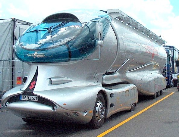

    A fuel cell liquid carrier truck would look something like this:
    I don't see a problem with designing a H2 tanker-truck that siphons off hydrogen that has 'boiled off', thus simultaneously supplementing the H2 fuel tanks while maintaining the cryogenic temperatures of the fuel, as it is delivered.
    Such a setup would have essentially unlimited range:
    6 mpg in a diesel ICE would be 12 mpg in a FC.
    10,000-gallon cargo tank would be 2,000 gallon of diesel-equivalent.
    So, allows long-distance transport of H2 from production facility to gas station EVEN WITH NO H2 STATIONS ALONG THE WAY!
    Think about that......the truck above has a theoretical range of 24,500 miles between fillups (2000 gal diesel equiv. x 12 mpg) + 500 miles from tanks on semi cab.
    Of course, every gallon of H2 used from the tanker is 1 less gallon that can be sold, but it just goes to show that one does not need a "Hydrogen Highway" in order to move H2 from produces to sellers, anywhere in the country....in fact, this type of FC truck would make delivery of H2 possible now
    THIS is where the research should be, on the infrastructure side.......but instead, all the $$ are going towards the consumer/passenger car side

    Peterbilt's New "Super Truck" Gets 10 MPG—Double the National Big Rig Average
    Yes they are...but relevance?
    It's Not Exactly a Prius, Folks - Popular Mechanics

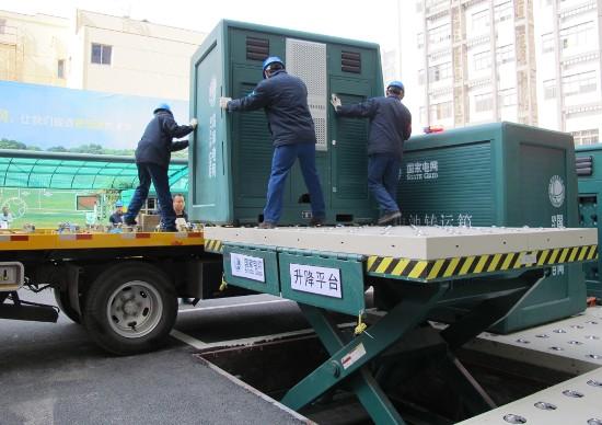

    Allow me to be the first person to discuss putting batteries on long-haul trucks. :)
    Yes, I calculated that the battery requirements would be about a Megawatt-hour for a 500-mile range truck. Will we ever get to a density of 1 kwh/kg? Hopefully. Even half that would mean a battery of 2000 kg.....not insignificant but not bad for a 40,000 kg truck. Now, imagine a standardized battery. It would be much easier than for cars, and a network of swap stations along major routes would probably be cheaper than H2. Imagine the swap stations taking the battery off and replacing a new one in less time than a fill-up, and then charging them with surplus overnight wind from an adjacent wind farm. You have to start thinking outside the box!

    On your hydrogen efficiency argument here is toyota's, which I find quite dated and incorrectly handicaps plug in efficiency versus today's real cars, as well as looks at yesterdays grid. A newer version is used by hyundai
    Hyundai Skips the BEV and Goes Straight to the Fuel Cell - CleanMPG Forums
    But you will note quite clearly that this uses the average US grid. What happens if you live in california? Let's go to the source of that graph.
    http://www.apep.uci.edu/3/Research/pdf/SustainableTransportation/WTW_vehicle_greenhouse_gases_Public.pdf
    Here the BEV charged with the california grid produces less ghg if that is your measure of efficiency than hydrogen. That seems like a better test, since the fuel cell vehicles they are trying to sell in the US can only run in california.
    What if you use solar or wind, as 39% of plug-in drivers in california polled use? That is an even lower ghg footprint. I don't know how to convert solar to vehicle efficiency, but a plug-in should run about 3x the distance on the same amount of solar electricity.
