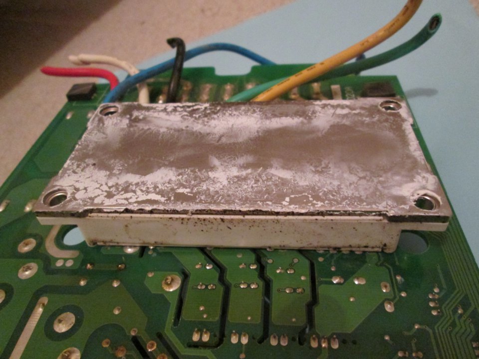

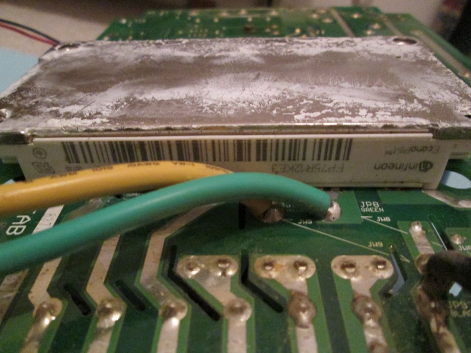

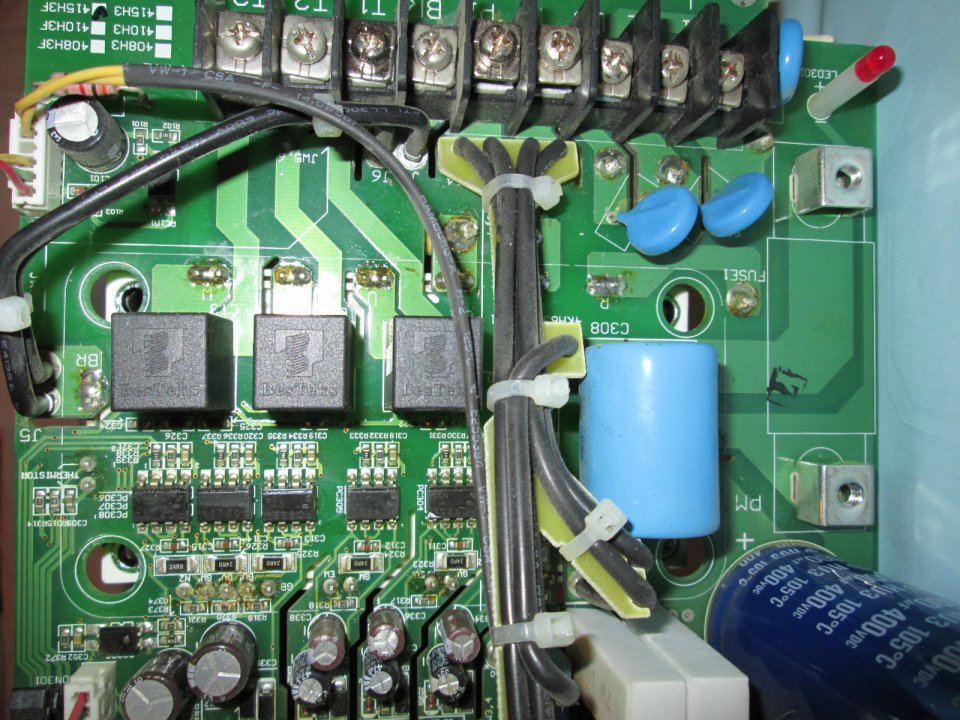

    Anyway, as per my earlier comments, I'm surprised by the roughly made look of the inverter innards. Maybe it's a cost thing, but I would have expected them to use off-the-shelf commercial components, such as this IGBT package, used in a standard VSD. Not sure what drive this was out of, somewhere between 4 and 11kW, I think. The module is an infineon FP75R12KE3, 75 Amp, 1200 Volt unit. The datasheet is here.
    There will be many like this available in different ratings to suit various applications. I don't know why they didn't go with parts like this, as most of the hard work is already done for you. Three of these should have been enough to do the whole job, and would probably have taken much less space. (If you want to see a real grunty 3-phase IGBT Module, check out this 1200 Amp, 3300 Volt item from Mitsubishi care of Wikipedia.)
