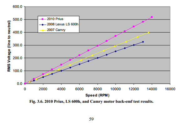

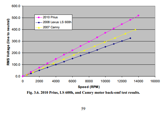

    You may think that a bicycle dynamo has no resemblance to the Prius Motor Generator, and you'd be half right. In fact, when operating as a generator, the two have very similar characteristics. They both produce an AC output voltage, the frequencies and voltages of which are directly proportional to the shaft RPM.
    That this is true of the Prius MG when running as a generator is confirmed by the following graph from the Oak Ridge NL document. Notice that the lines are dead straight. Back EMF is another term for generated voltage when referring to a motor, and it is the existence of back EMF that causes the motor current to drop as the motor speed increases (for the same applied voltage).
    My point is that when the back EMF falls below 200V (the graph is of Phase to Neutral voltage so doesn't relate precisely but you get the idea), then NO REGENERATION POWER will be consumed. The battery requires more than 200V to charge, so at motor speeds below the point at which 200V is output will not produce any Regenerative Braking.
    This is in fact an argument in favour of a lower DC battery voltage (rather than higher as proposed by other posters), but the question remains - how is the Regen Braking achieved at low road speeds?

    For what you say, I suspect those probably fall under the category of "Brushless DC motors". Similar, but I think not so relevant. As I described, the Prius Motors are 3-phase PMSMs. Similar to ordinary AC induction motors, but with Permanent Magnet rotors (like the bicycle dynamo I mentioned - when acting as generators, that is).
    Yep! Standard 3-phase AC motor control, pretty much identical to what is found in an ordinary 3-phase VSD. Even the parallel diodes are there, except they perform an additional, completely different function in the motor/generator setup. They create a standard, full wave, 3-phase Bridge Rectifier to convert the AC from the motor windings into HV DC, to recharge the battery.
    Check out the circuit diagram for the std, off the shelf, 3-phase VSD IGBT package I posted earlier. All Toyota have done, as you have described earlier, is build the IGBT/Diode package themselves, and gone to extreme lengths to make the Thermal Resistance from junction to coolant as low as economically possible. Knowing this, I don't buy the idea that the IGBT dies are overheating due to "normal" full load currents or voltages. There has to be a software bug in the original Gen3 code that infrequently causes abnormal currents or voltages to damage the devices.
    Anyway, another likely reason (haven't looked into it) that they had to build these inverters themselves is that the "freewheeling" diodes in the standard IGBT packages are not big enough to withstand full-on Regen current. So they possibly decided, well, let's do it ourselves.
    Yeah, I know... Check out the BackEMF graph I posted above.
    Sure, the motors generate well over 200V, over the upper 2/3 of their speed range. I recall reading somewhere that the max speed (not sure which model) with the ICE off is 62MPH. On that basis, at speeds below about 20MPH, no regenerative battery charging is possible.
    So what's happening below 20MPH? Is it a trick which just looks like regen braking/ battery charging, but really, it isn't?

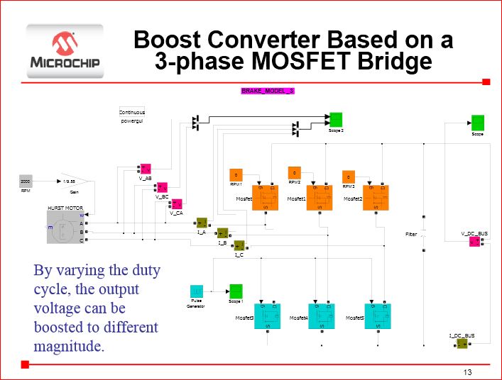

    The boost converter is not used during regen braking when the back EMF is less than the battery voltage, instead the winding drive transistors are used and functions like a boost converter.
    See diagram below.
  15. KiwiAl

    Now we're talking! I get the concept - VERY cool! I can't read that diagram, too low res - but I get the idea! I couldn't figure before where they would get the extra inductor they'd need, but they must be using the idle one inside the motor. That is VERY, VERY clever. But I'm not yet convinced of it in practice.
    Anyway, if that is what they are doing, then, well... It's pretty easy to see how a timing error could result in momentarily shorting two of the IGBTs across the 650V rail under certain regen conditions...
    Need to think about it. But many thanks!
