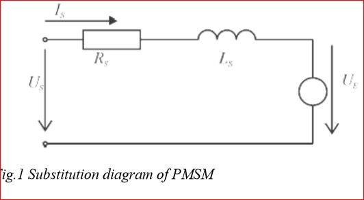

    Hi KiwiAl,
    Here is another hint for you. The model of the motor winding is as the diagram.
    Ue is the back EMF, during regen, Ue is the voltage in the winding and the inductor is the inductance of the winding. You now can figure out how the drive transistor can be use as the switch for boost converter.

    I'm not sure how the substitution diagram helps, as yet. I know it's a 3-phase motor. Although motors can be, and often are, connected either way, I'm pretty sure that the windings in a Generator cannot be connected in Delta, as the idle winding will then be shorting the two active windings. This would mean the motors have to be connected in Star (or 'Y' or Wye).
    The (unmodified, unloaded) three phase Generator / Back EMF waveforms are as per the graph below. I have put the green box around the zero-crossing point of the black phase, and the grey lines represent the sum of the other two (the active) windings.
    I know we want to boost the output voltage from say 100V to over 200V, and I'm sure this is done by alternately dropping the Star point voltage across the idle (black) winding, first one way then the other, but haven't figured it out yet, and haven't Googled any of it. Let me persevere.

    Hi again bedrock8x
    I conclude after a few minutes more on this that my initial approach (and graph) above, was incorrect. I now think that what they must actually be doing is PWM "shorting" to ground via the relevant IGBT, each winding in sequence during its +ve voltage cycle peak (e.g Black phase at around 90 degrees), to cause the winding currents (all three of them) to increase (as in the regular Boost converter), so they can then harvest the increased voltage in the same way.
    I will now go away and do some more research to see if this is correct, but if it is, then I guess there are plenty of good opportunities to overcurrent the IGBTs - for example, leaving them on too long, or accidentally overlapping the ON times so that two of them end up shorting the rail capacitor... I can imagine that in the "Battery Getting Too Hot" routine, they could have tried to compensate for the loss of Regen Braking by trying to soak up energy in the windings instead as per the substitution diagram (but not a great idea?)... Who really knows?

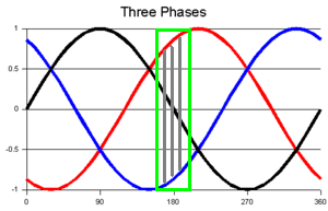

    It depends on the instant you are looking at... Don't worry about this, but if you look at the 3-phase AC waveforms, you'll see that at different times, one winding is positive, 2 negative, then 1 +ve, 1 -ve, 1 0, then 2 +ve, 1 -ve.... They all change around as the machine rotates.
    Pairs applies to the Single phase Bridge. In a 3-phase bridge, you need to think in triplets. They transition from one to the next - one starts to decrease while the next starts to increase, and so on. It's like the difference between a 2-cylinder engine and a 6-cylinder engine. In a 6, the power strokes overlap, so you get much smoother power, (and a completely different, continuous exhaust sound, FWIW!)
    Six times! If you look at the "fancy" graph, you'll see it relates to one revolution. There are three pulses in the top half and 3 in the bottom. The Full wave Rectification effectively turns the bottom three up the other way. You'll see they fit between the existing three, to give six in total. Much smoother DC than single phase, full wave.

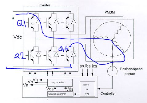

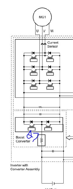

    Here is another hint.
    Take one phase of the winding, the back emf cannot complete a path through Q1 and Q6 . If no IGBT is turn on there is NO re-gen. If Q7 is on regen is possible if back EMF is higher than battery voltage, but when back EMF is close to battery voltage, regen is very small.
    Q2 can be PWM switching to generation higher voltage to create more regen. Of cause regen creates braking power, if the driver brake hard, the Q2 can go to higher PWM period to create higher voltage, then brake force increases.
    Sorry I made a mistake, Q7 should be in the boost converter not the drive IGBTs.
