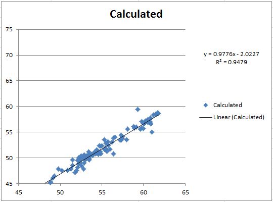

  13. Jonny Zero
    Jonny Zero Giggidy
    Jun 22, 2012
    1,388
    352
    Austin, TX
    I plotted a hundred data points and fitted a linear equation. Look at the regression value. It is plenty precise. I think it is easily fixed if they want it to be accurate.
  14. PuckSR
    PuckSR Junior Member
    Sep 18, 2014
    35
    You plotted 100 data points for YOUR car or for a bunch of cars?
    Also, that might be the worst graph I have ever seen. You apparently "calculated" a lot of stuff. I have no idea what the X or Y axis represents. I am going to assume that one is your listed MPG(which is calculated) and one is your measured MPG(which is actually measured, and not calculated).
    Look, I totally believe that Toyota and most manufacturer's fudge the numbers to make them look better. My argument is that they do this for entirely innocent reasons. Namely, they didn't want a bunch of people bringing in their cars when they weren't getting EPA MPG. Also, there is some variability in MPG between vehicles for numerous reasons. If you shade everything to look a little better you get fewer people complaining about a non-issue. People who are stupid enough to totally trust the car computer for MPG are stupid enough to bring their car back to the shop and complain when it gets less that 45 MPG because they drive with a lead foot.
