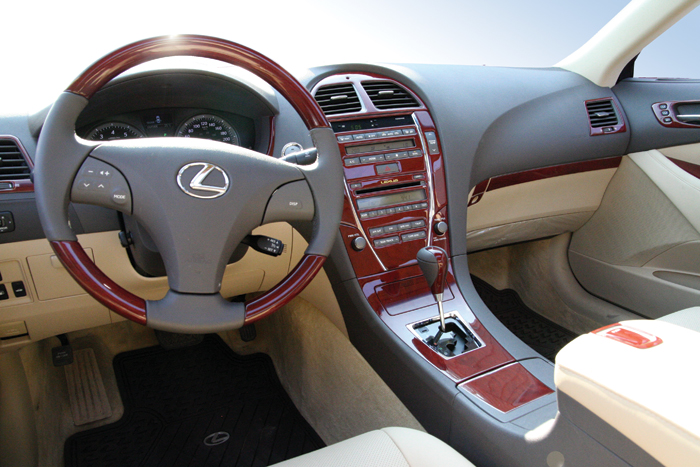

    I just have to comment on an article posted a few pages back. It says one of the "Design" flaws in the car is the automatic transmission shift gate may "make it difficult to shift into neutral when the car is moving."
    Looks like a standard staggered shift gate to me. It looks like if you have it pushed over to the manual-mode to the left, you have to push it back to the right first before merely pushing up for neutral. How is that a design flaw? I suppose perhaps in the panic the driver moved it over to manual mode accidentally and was flustered why pushing up didn't go to neutral. But just look down to see what's going on. Perhaps he's just use to Police Interceptors (aka Crown Victorias)
    Surely when the car shot out of control it wasn't going 120mph right away as he should have been able to control the speed at first before the brakes overheated.
    That article just sounds sensational and ridiculous... typical useless media.

    indeed, shift gate looks standard ... what's the problem here?
