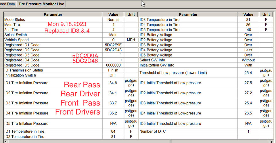

    On a gen3 Prius you don't program the tpms sensors. Each sensor has a unique id which must be written into the vehicle's tpms ecu.
    If you get them installed without writing down each id, Autel sells a special radio frequency reader which can rf read the ids in the tire. Most tire shops have this tool. It's a little pricey and most diy'ers would never need it when a piece of paper and a pen or your phone could have noted those ids before their installation.
    Recent Toyotas do have an automated procedure that can read installed sensor ids and write that data into their ecu. However gen3 Prii can not do it by themselves.

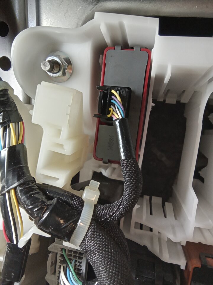

    On Gen 3 Prius models, it's easy to turn off the light. No tools are needed.
    Just lower the bottom glove compartment and insert a solid 24 gauge copper jumper to connect positions 5 and 6 in back of the block.
    Looking at the back of the block with the release tab on the left, these are the two bottom left.
    Just pull the jumper, if you have tires with good TPMS transmitters.
