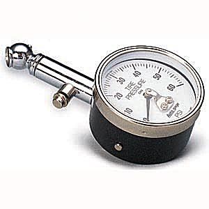

    This is a lot easier to find and used.
