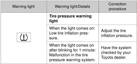

    Thanks. I checked out the owners manual already before posting and have identified the issue as a TPMS issue. I should have stated that in my initial post, but I figured checking out the owners manual was a given before posting on Prius Chat. Similar to how going through the available threads that are already on Prius Chat is the standard before posting.
    My question was more about if the TPMS sensors work off of a main sensor or how that all works, in hopes I can diagnose the issue and identify what parts need to be replaced. But it's always nice to go through the basics just in case!
