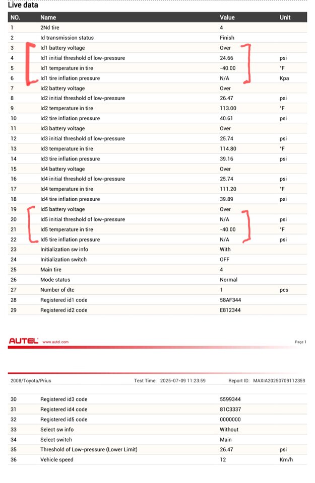

    So, I ran a live data set on the prius today while driving and noticed id1 (#3-#6) and id5 (#19-#22) are not providing any feedback like the other 2 id’s (i assume “id" indicates TPMS sensor).
    I found this info from another post on here:
    ID1 Front Passenger Side
    ID2 Front Driver Side
    ID3 Rear Passenger Side
    ID4 Rear Driver Side
    BUT then read this from @ChapmanF
    “ The ID slots will correspond to different positions after the rotation. Each sensor permanently has its own sensor ID number. The sensor is mounted in the wheel and goes wherever the wheel goes.
    In the tire pressure ECU, there's a level of indirection: the ECU can remember up to five sensor IDs (in case you add a sensor for the spare, not there from the factory), in slots named ID1 through ID5. In each of those slots you'll see the actual several-character ID of the sensor that was registered in that slot. There's no special meaning to the five slots, they just have the sensor IDs that have been registered with the ECU, in whatever order they were registered. So if slot ID1 has sensor id 1234abcd in it, and that's your right front at the moment, and you then do a front-to-back rotation, slot ID1 will still have sensor id 1234abcd and it will be the right rear wheel.”
    Soooo, it does give me some insight somewhat now about why I see 5 ID’s on the live data but even with the info above now, I would not be able to use it or go by it as wheels may have been switched around while tire replacement happen. I do recall though, prior to tire replacement, the TPMS fault always showed up on ID1 like now so perhaps the wheels were put back in the same location when the tires were swapped. So now I have to figure out which is ID1 and ID5, I highly doubt the spare donut has a TPMS sensor as I read they do NOT come from factory and it was never used until now.
    Here is the TPMS live data screenshot:

    You only need to find the location of ID1 (non-working) sensor on the car. There is no ID5 sensor since a sensor is not mounted in the donut spare tire. FYI, you do not need to be driving the car to look at the TPMS live data on the scanner. The car can be stationary, but it needs to be turned on.
    To locate ID1 sensor, all you need to do is choose one tire and lower the tire pressure by 10 psi or so. Then, look at the live data on the scanner. Did one of the three working sensors show a decrease on the screen? If so, you now know where that sensor is located on the car. If none of the three working sensors show a decrease in pressure, then you know that you have found the non-working sensor. You may need to check all four tires until you find the non-working sensor ID1.

    As you're able to view live data, you can just go let a few psi of pressure out of each tire, one by one, and watch for which live data readings change. Then you'll know which IDs go with which corners of the car right now (up until the next time you rotate tires). Of the two that don't report, of course that won't tell you which is which, but you will find out which two they are.
