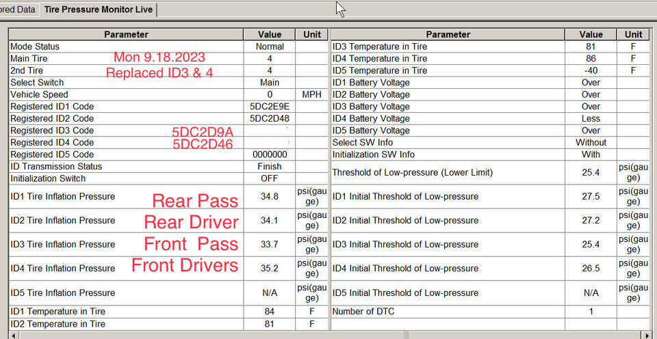

    Most likely the id programming in the car's ecu is done (as you indicated much earlier), the sensor motion detectors turn them on (activate not the proper word) and "possibly" you set the tpms alarm point at zero.

    Just in case, I reset the TPMS by jumpering 4 and 13 on the OBDII port for 30 seconds (diag mode appeared on MFD). I then re-registered the new sensor IDs. I drove around for a while but still no TPMS light - maybe it will just take a while to pop up.
    I've attached a screenshot of the TPMS data after the reset and re-registration.
    I'm booked in to get the sensors installed tomorrow. I was hoping to have the TPMS light present so it going off would indicate all sensors have been "turned on". I think I'll go ahead with the install, and then have to check afterwards whether the ECU is communicating with them.

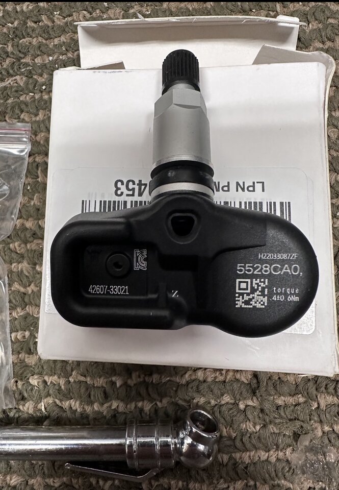

    TPMS alarm initiation is normally done with the switch under the drivers dash. See owners manual.
    Take a picture of the ids before install, have them installed and then drive about 5 minutes or less.
    The id on this one is
  11. ChapmanF
    28,762
    19,088
    Caution for anyone looking at the photo in #8 and thinking "Oh! So ID1 is rear passenger, ID2 is rear driver side, and so on!"
    Nope! The IDs don't go with particular corners. They're just four arbitrary slots to register your transmitter IDs in. You can make notes like in that photo to remember which one you put in which corner, but if you do, you have to remember to update the notes (correctly!) each time you rotate the tires.
    Also, if you have work done at a tire shop, they'll often use a tool that reads all the transmitter IDs and programs the car's ECU with them. They might do it for convenience without you asking. It can result in you having the exact same 4 transmitter IDs registered that you came in with, but not in the same numbered ID slots, so your notes will be thrown off again.

    You can also release some air out of working sensors while scanning to see which is which.
    Techstream also shows battery status. ID4 was low.
    In my case I was doing two and wanted to know where they were prior to going to the tire shop.
