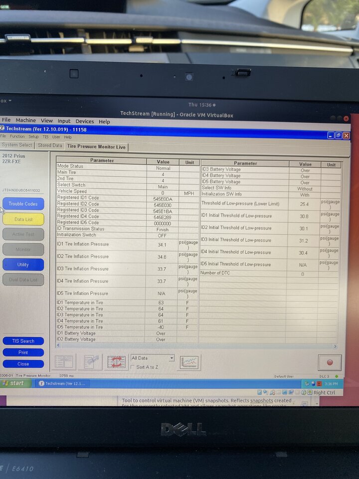

    I replaced my TPMS sensors in each tire this summer.... Worked without issue for months.
    The light is now on and I immediately assumed that a cheap sensor was bad. Connected techstream and saw several pressure values. All seemed reasonable. It looks like the Low threshold (sorry I dont remember the name) was around 26 PSI. I think all of my tires were around 31-34 PSI and some other indicator pressure (there were four values) were all slightly different but very high... 28-30.
    I would like to do a sensible reset of this system. If I verify all cold pressures are around 35PSI should I be able to use the TPMS reset to get that light off? Not really sure how it works. I didn't find it in the owner's manual at first glance. I also saw temp readings that were similar to the outside temp 30 degrees. I hope cold is good for a reset.

    Post a picture taken of the Techstream data for the tire sensors.

    All the tire sensor data looks okay in the picture. Was the low tire pressure light on when you took the picture?
    What is the trouble code(s) shown in techstream? Post a picture please after running a health check.

    That live screen shows 0 for Number of DTC. So there don't seem to be any DTCs at that moment. If the warning light was on right then, I'd be at a loss to say why.

    I missed that when I looked at the data in the picture. Nice find.

    Does that mean the low tire pressure light was on today (Thursday) when you used Techstream to look at the live data and took the picture?
    If the light is still on, please run health check and post a picture of the results and take a picture of the dash showing the light. Also accesss the live data for the tire pressure sensors again and take another picture. Thank you.

    Zero DTC means zero current DTCs.
    I would assume there is a historical code lingering, but the OP would naturally have checked this by clicking Trouble Codes I would also assume…:)
    In the event there is no HIST code I would suggest any or all of these;
    1. entering all IDs again in the Utility screen as this may force a more complete recheck.
    2. wipe DTC/FF memory regardless, on the main screen, or disconnect negative battery cable for 2 minutes.
    3. Release 25% and re-add pressure on all four tires.
    Frontporch likes this.

    the light was on when I took that picture with techstream. I hooked up the computer after getting home from a 20 minute drive
    just for my knowledge if I were to inflate to 40 psi and press the TPMs reset would that change the initial threshold of low pressure to be some percent of the current 40 psi for all tires? Does dropping below that value trigger the light or does any one tire have to fall below the other lower limit of 25.4 psi
  15. ChapmanF
    28,721
    19,022
    yes
    yes
    that minimum limit is just the lowest it will allow you to set any alarm threshold (say, if you were to press the SET button while a tire was flat, it wouldn't set the alarm threshold to 0 for that tire, but to the minimum threshold).

  16. priumium
    priumium Member
    Sep 8, 2024
    335
    81
    Sweden
    2013 Prius Plug-in
    But, for informational purposes, if you deflate all tires to 20 psi and press reset button, ECU logic would set low pressure at around 15 psi and ignore lower limit. Likely a big bug, attest in my firmware.
    The concept is 25% of the lowest pressure unless below limit mentioned.
    This is just for testing information. Never run car deflated below 35? Psi / 2.3 bars EU.

    That is very weird because the DTC that is shown on the picture is 0 which means that there are no tire pressure sensor errors detected. The low tire pressure light should not be on.
    I would not reset the minimum tire pressure threshold just yet.
    Can you please take a picture of the dash showing the light. Thank you.
