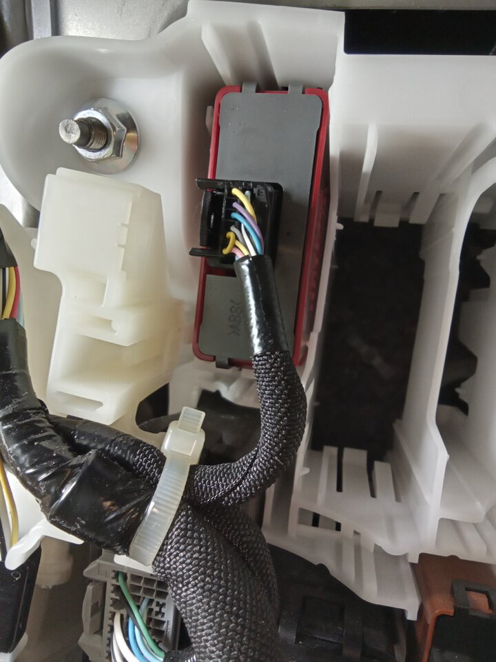

    I turned off the TPMS light and never looked back.
    On Gen 3 Prius models, just jumper positions 5 and 6 on the back m of the connector block with a thin solid copper wire as shown in this photo.
    I check the pressure in my tires every 2-3 weeks.
