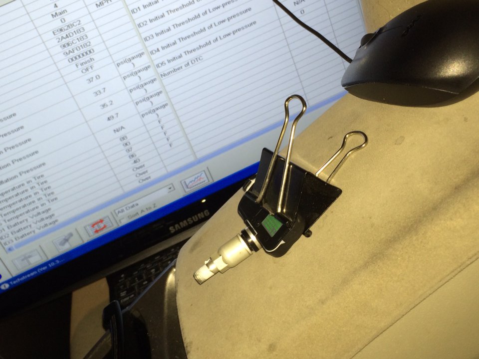

    (1) But yes! I have shown a way here on PriusChat to generate a fake pressure reading on Gen2 OEM Denso TMPS with a big binder clip, but you still need a TPMS unit. Too lazy to search right now....all there with pics. Lasted 2 years for me,
    (2) Another temporary option is to reset the codes, and it takes a long drive >20-30 minutes for the system to realize the TMPS are dead. Some people who only take short trips can go a long time without the warning light coming back on

    But if the TPMS sensor is working properly and transmitting, the system will read the low pressure and alarm right away.
    Now, take that sensor away from the car....you will see the old reading still in the register. Lets say its a good pressure 35.
    That will stay on the register for about 20-30 minute drive, until the system finally gets smart and realizes that is stale reading.
    Also if you reassign new bogus codes, eg 0000000 it will take 20-30 mins for the system to wise up.
