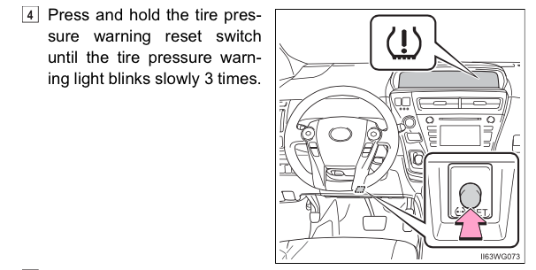

    Maybe I am just as dumb as a bag of rocks today... but I cannot find the reset button for the Tire Pressure Monitor System (TPMS) on my 2015 Prius v Wagon w/ATP.
    The screen shot attached shows where the reset button should be. There is one on my 2006 Prius, but for the life of me, I cannot find it on my car.
    Does anyone with a 2015 Prius v Wagon actually have a reset button?
    /Jim

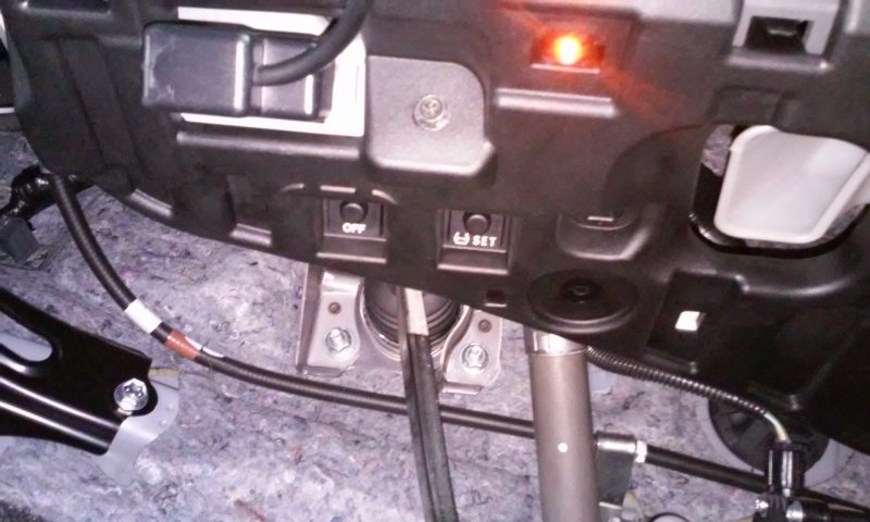

    It's just really buried deep underneath the steering wheel. You got to stick your head all the way down there underneath to see it. You (w/ ATP) should also see a Smart Key System on off button next to the TPMS reset button.

    Just went out to look for myself in my 2012 Prius v w/ ATP. First I found that I could not get my head under the steering wheel until I drove my previous out of the garage and had to room to kneel next to the driver side door. Then my first attempt at the crouching craning button peeper yoga pose failed to view the buttons. Turns out you need to perform the planking crouching craning button peeper yoga pose to view the buttons. They are recessed up underneath the footwell behind the LED light. If you looking level into the driver footwell you will not see the buttons. You need to be planking looking upward to where the brake pedal goes into the firewall.

    It is way behind the knee airbag system and now faces directly down toward the floorboards. It is about 3/4 of the way back toward the brake pedal. I ultimately used my iPhone camera in "selfie mode" to find the darn thing. It is directly aligned with the arm of the brake pedal about an inch or two forward of where it travels. Knowing where it is in advance will allow use of the braille method of activation... assuming of course that you are under 65 and have sufficient memory capacity.

    Here is what it looks like in the 2012 prius v w/ ATP.
    I like that Toyota moved TPMS reset button to he Head Unit touch screen. One less button.
